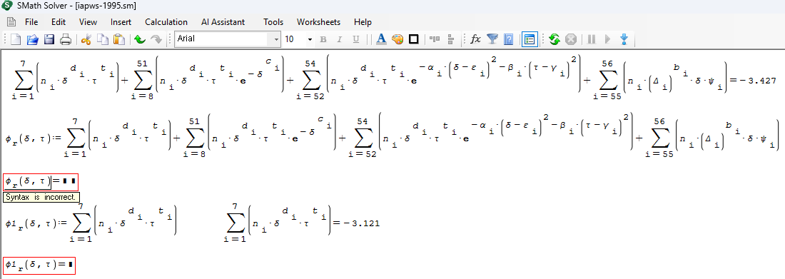

#1 Опубликовано: 22.05.2026 16:47:56
Valery Ochkov
Valery Ochkov
See the end of the sheet.
iapws-1995.sm (220,46 КиБ) скачан 502 раз(а).
Отредактировано 22.05.2026 17:26:14

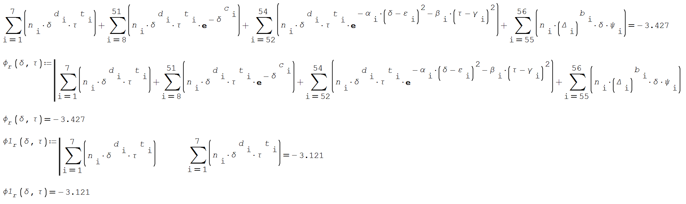

#2 Опубликовано: 23.05.2026 05:08:54
Hi. Use line(#) for prevent the evaluation.
iapws-1995.sm (220,77 КиБ) скачан 508 раз(а).

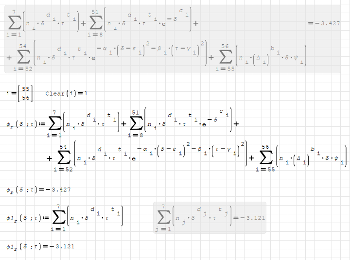

#4 Опубликовано: 23.05.2026 11:03:47
This happens because your i is not empty.
Try to clear it or use something different for sum iteration.
j would be appropriate.

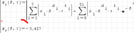

#5 Опубликовано: 23.05.2026 11:19:15
2 343 сообщений из 4 056 понравились пользователям.
Группа: Super Administrator
Thank you overlord!
Another way is to use line() at the rhs:

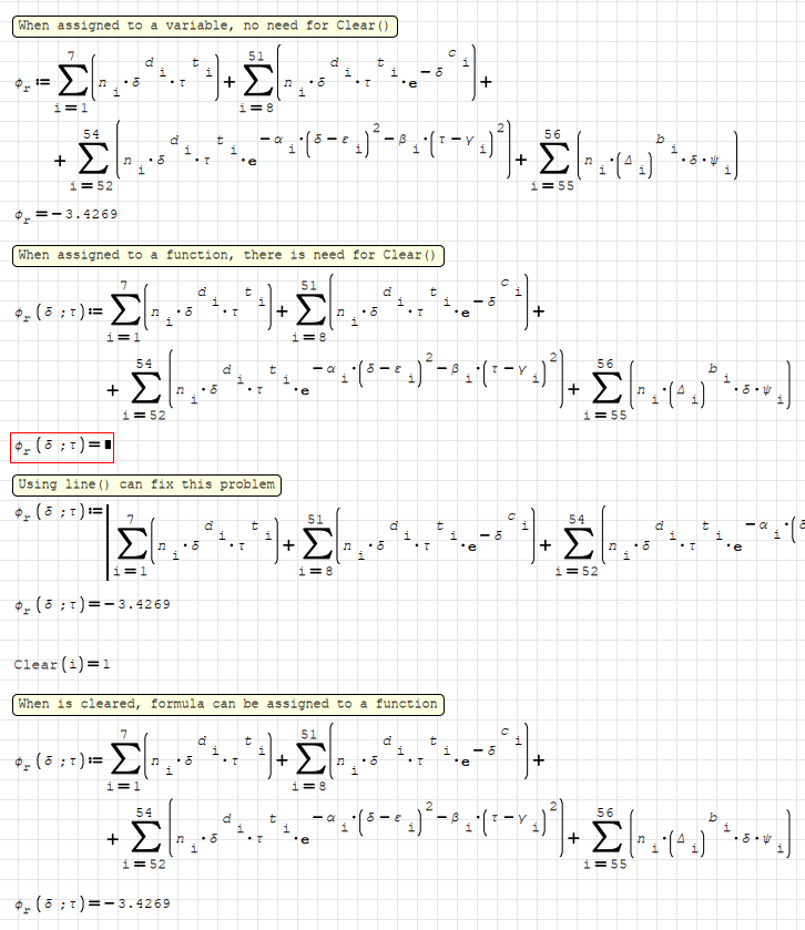

#6 Опубликовано: 23.05.2026 16:18:22
Don't know if this is a bug or limitation.
But when formula assigned to variable or used directly, it can be calculated.
When assigned to a function, it can't be parsed.
