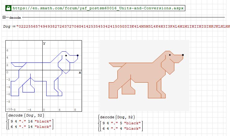

Yes, thank you, it expands the space, but it's not very intuitive. Maybe we can sacrifice the numbers and leave only the letters? Small letters are positive coordinates, and large ones are negative. Zero can be left in the middle. Maybe we can change the sequence like that?
P.S. Although no, you can leave it as is ( there is a coding function ). This is not very intuitive for manual coding, but for automatic coding it is normal.
You can name the function with one word - codec. Processing depending on the argument type. Also, when encoding, you can automatically determine the size of the area and specify the second parameter with the first two digits in the text. When decoding, it will be clear which alphabet to use.
I want to add examples of drawing by points to the X-Y Plot plugin, to the context menu, but the standard usage is too long. So I came up with the idea of ​​making coding for polylines as text.
If I find a universal convenient algorithm, I will include such text lines as an alternative option for specifying polylines.

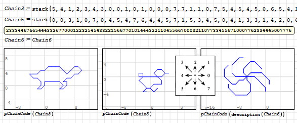

Hi Viacheslav. Another code: Freeman Chain Code of Eight Directions.
Chain Code.sm (17.74 KiB) downloaded 1891 time(s).
