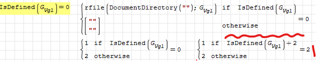

Hi!

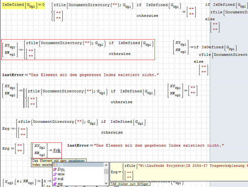

I used the red bordered equation (and similar constructions) for a long time.
But this doesn't work no more.
Even if the result of the test is false, the true expression is evaluated, which fails in this example.
If/else does the job.
Assigning the equation to one variable works initially, but on second sight one can see, that the expression isn't really evaluated but only stored.
Is this all the intended behaviour? And why did it change?
Thanks,

Last change in cases logic was 3-4 years ago, so it's probably something in the program or something not experienced.
I changed some time ago from the last stable to the current beta.
Did a test with the Version 0.99.6884 (portable, 32-bit). (Should have done before posting.)
With this version the described behaviour does not occur.
