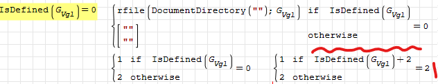

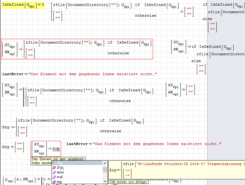

Hi!
I used the red bordered equation (and similar constructions) for a long time.
But this doesn't work no more.
Even if the result of the test is false, the true expression is evaluated, which fails in this example.
If/else does the job.
Assigning the equation to one variable works initially, but on second sight one can see, that the expression isn't really evaluated but only stored.
Is this all the intended behaviour? And why did it change?
Thanks,

#4 Опубликовано: 28.06.2020 19:47:17
Plugin updated, now it should work 1:1 as before (no evaluation is performed on definition).
Please be careful however, since a symbolic evaluation to show the function content or a failed evaluation with an error triggered on the conditions leads to the evalution of all the options.

Thank you Davide for your efforts.
With 0.99.72.51:
But now, the evaluation of the equation fails, even without assigning the result to a variable.
To me it looks like the result is the evaluated test clause.
With 0.99.68.84 it works.
#6 Опубликовано: 29.06.2020 08:20:56
With 0.99.72.51:
Thank you, I messed up with the code. The update is now deleted and I'll upload a new version ASAP. You can remove the plugin and reinstall the latest.
