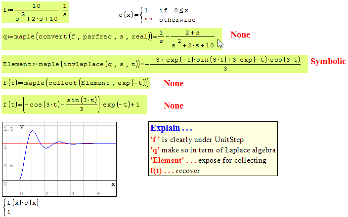

That one was well covered
... when you deal with Laplace stuff, open your school book,
that will help setup Laplace Algebra appropriately, like this:

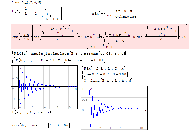

Hi. Improved version, works faster. Coefficients for the inversion are precalculated outside the inverter caller and avoiding vectorization for more compatibility of the inverter.
InvLaplace3.sm (98.32 KiB) downloaded 1431 time(s).

Any real use for this old style inverser,
vs Maple export c/w parameters that works much faster.
Saludos ... Jean
Laplace Maple Parametric Export.sm (15.2 KiB) downloaded 1380 time(s).
