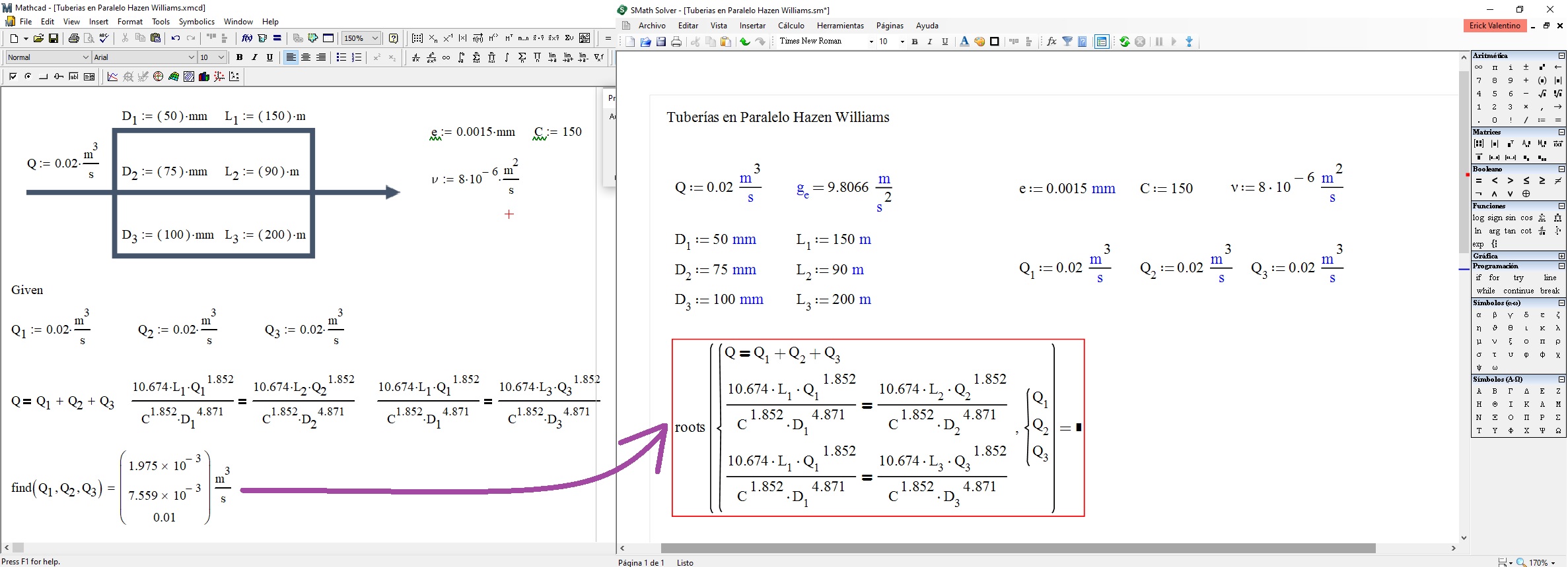

I would like to know how I can replace the "given" command from Mathcad to SmathStudio, I know that such a command does not exist in SMATH and for that there are other tools
I just need to find the flows Q1 Q2 and Q3 from a parallel pipe using the Hazen Williams equation, without having to do as many expressions
Thank you very much

Tuberias en Paralelo Hazen Williams.sm (13.37 KiB) downloaded 1247 time(s).
Tuberias en Paralelo Hazen Williams.xmcd (26.7 KiB) downloaded 1268 time(s).

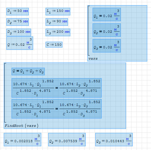

You can use Mathcad Block region for this.

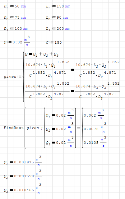

AFAIK, roots() won't work with units.
You can use FindRoots() for that purpose.

Or like this.
tuberias_uni.sm (12.14 KiB) downloaded 1235 time(s).

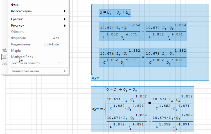

What the..? I didn't know you can use mathblock like this.
How FindRoot() can work under block with only one argument?
That is a very neat feature. Really appreciate you share this.
#6 Posted: 3/23/2022 12:32:03 AM
1,555 likes in 1,867 posts.
The first argument is implicitly substituted by the block itself. Then the function is called with two arguments.

It is located in the Mathcad Toolbox plugin and was created to repeat the generalized ODE solver from Mathcad. This is made for the future for the converter. I hope that someday the converter from Mathcad will be finalized and there should be unambiguous equivalents for it. Therefore, I try to fill the Mathcad Toolbox plugin with similar functions. There are many interesting documents and it would be great if they were completely converted. It would also make it easier to transfer documents and users
MathBlock would suits it more, just a suggestion.
I specifically set this name so that it does not interfere with the appearance of another similar block. Perhaps, after using the block, an understanding will come of how to make it a more convenient. For this case we will reserve this name (MathBlock).
