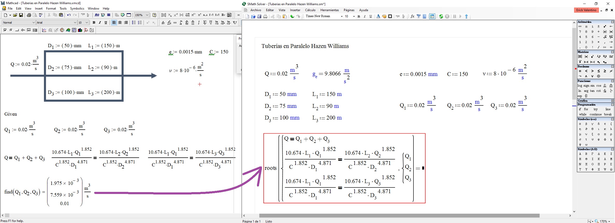

Hello! What's up

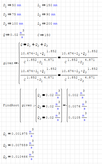

I would like to know how I can replace the "given" command from Mathcad to SmathStudio, I know that such a command does not exist in SMATH and for that there are other tools
I just need to find the flows Q1 Q2 and Q3 from a parallel pipe using the Hazen Williams equation, without having to do as many expressions
Thank you very much

Tuberias en Paralelo Hazen Williams.sm (13,37 КиБ) скачан 1294 раз(а).
Tuberias en Paralelo Hazen Williams.xmcd (26,7 КиБ) скачан 1355 раз(а).

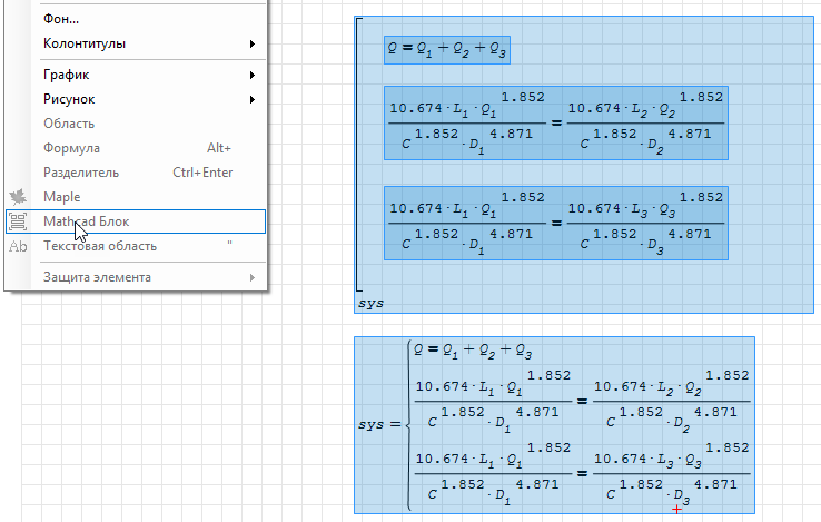

You can use Mathcad Block region for this.
Click to enlarge

AFAIK, roots() won't work with units.
You can use FindRoots() for that purpose.
Regards.
tuberias.sm (11,75 КиБ) скачан 1331 раз(а).

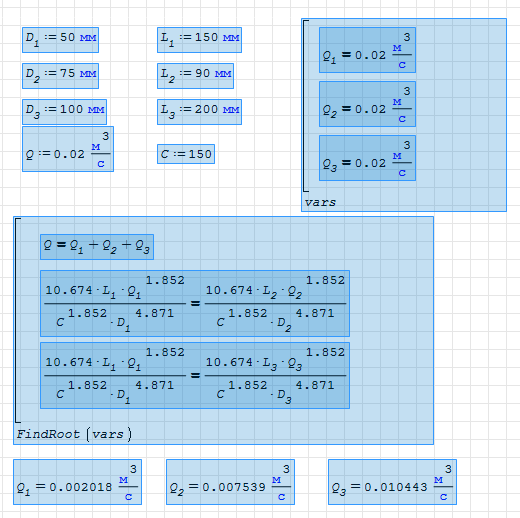

#4 Опубликовано: 22.03.2022 17:35:27
Or like this.
tuberias_uni.sm (12,14 КиБ) скачан 1294 раз(а).
Erick Valentino 22.03.2022 19:55:00, overlord 22.03.2022 20:56:00
#5 Опубликовано: 22.03.2022 20:59:10
Or like this.
What the..? I didn't know you can use mathblock like this.
How FindRoot() can work under block with only one argument?
That is a very neat feature. Really appreciate you share this.
#6 Опубликовано: 23.03.2022 00:32:03
The first argument is implicitly substituted by the block itself. Then the function is called with two arguments.
Click to enlarge
