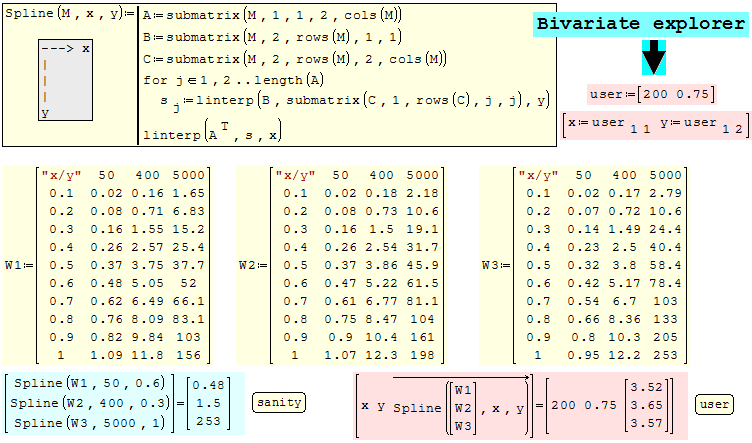

#1 Posted: 11/22/2017 10:45:06 PM
Spline Matrix Tutorial METRIC Domain.sm (88.16 KiB) downloaded 1417 time(s).
frapuano 11/23/2017 3:48:00 AM, sergio 11/23/2017 8:36:00 AM
#2 Posted: 11/23/2017 8:39:27 AM
The bivariate "linterp" is reputed behaves like Quadratic
Spline Matrix Tutorial METRIC Domain EXPLORER.sm (14.73 KiB) downloaded 1357 time(s).

Hello.
I think I understand the idea. I will think about this. Thank you for your insistence. However, it also counted the very simple and schematic form you used here and you did not use it on the other subject. With respect and all the best.
