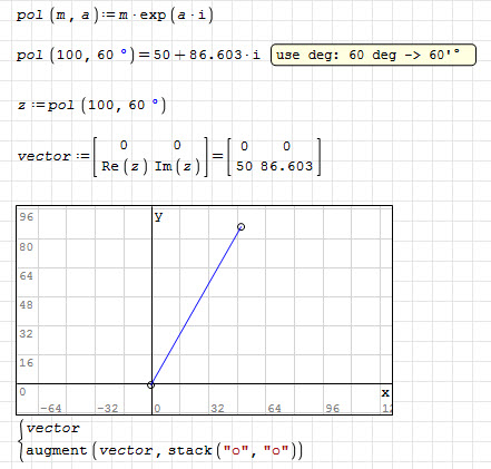

#2 Posted: 5/27/2022 1:57:54 PM
1,558 likes in 1,868 posts.
You can use this method
#3 Posted: 5/27/2022 8:25:23 PM
Joseph Lo
Joseph Lo
0 likes in 4 posts.
Thanks uni for that. I tried it and it seems to work - but is it possible that i don't key in the "degree" sign and still get the same result? i.e. the polar form of 100/_60deg = 50 + j86.6.
If I dont put the degree sign it will return -95.24 -30.48i which is a different result.
Thanks

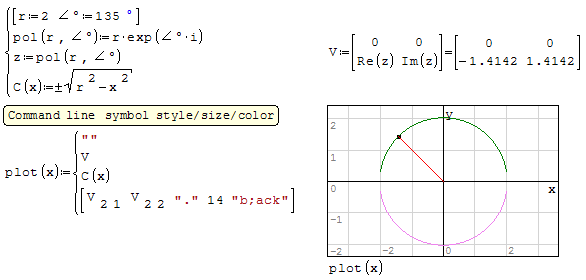

#5 Posted: 5/28/2022 1:24:22 PM
Plot the circle as well.

#7 Posted: 5/29/2022 1:46:01 AM
Joseph Lo
Joseph Lo
0 likes in 4 posts.
Interesting thanks for that. I will experiment with that.

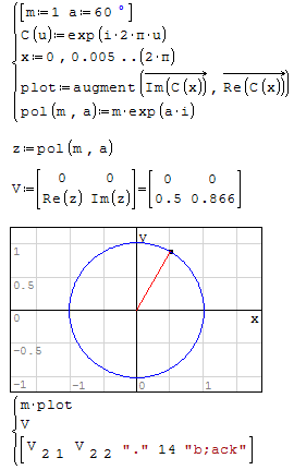

#8 Posted: 5/29/2022 8:36:55 AM
You can have it Class Room style.
Cheers from Up There to Down Under ... Jean.
Polar Circle.sm (5.84 KiB) downloaded 1308 time(s).
