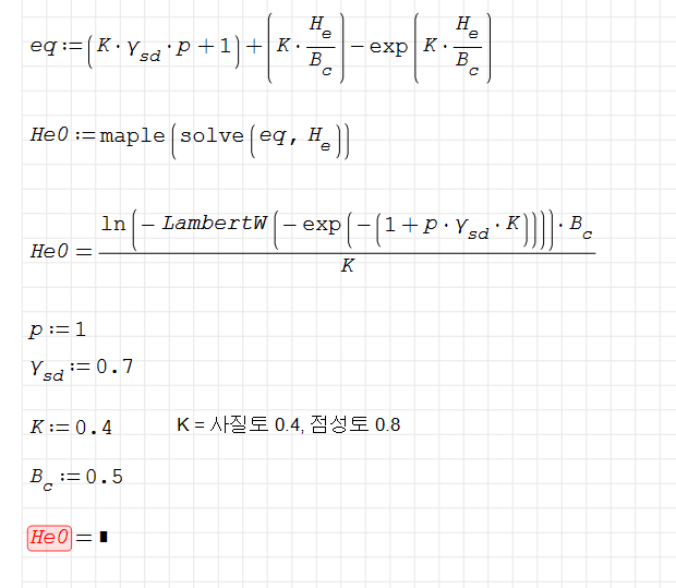

i want to solve this eq.
He0 = ??등침하면의 높이.sm (6.22 KiB) downloaded 493 time(s).

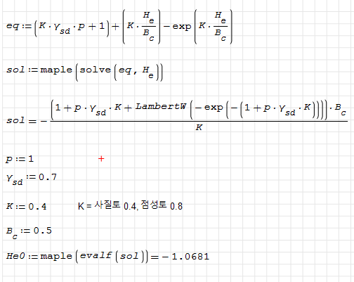

Hi. It's a function that Maple knows, but SMath doesn't. I suppose the most practical solution is to ask Maple to evaluate it numerically, once the parameter values ​​are known. evalf is for "eval with float point".
등침하면의 높이.sm (6.74 KiB) downloaded 501 time(s).

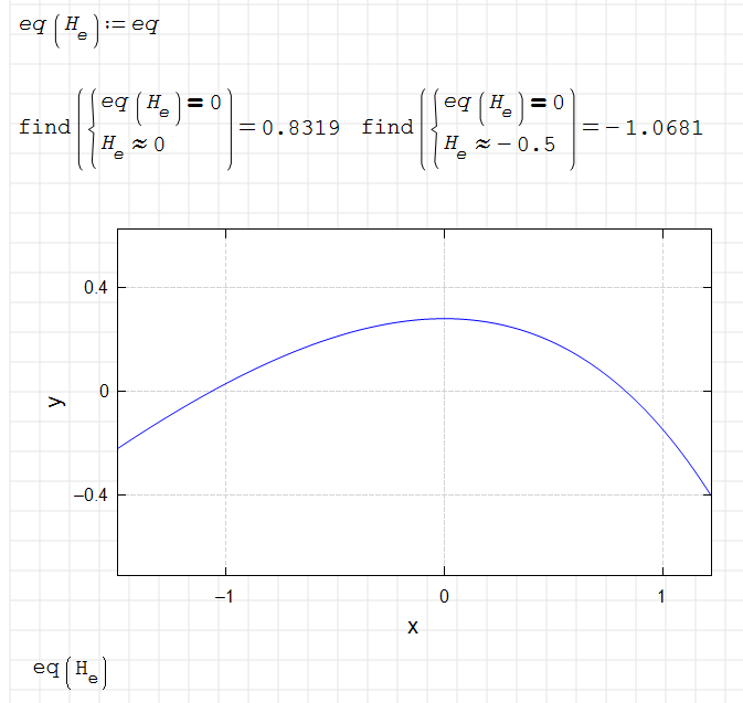

If you plot eq as a function of He you will find there are two solutions: one close to He =-1.068 and another close to He = 0.832 (for K = 0.4).

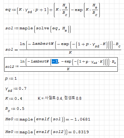

Hi. This is the analytic solution for the positive root, taking another branch in LambertW function, indicated by the parameter -1
등침하면의 높이.sm (7.95 KiB) downloaded 460 time(s).
