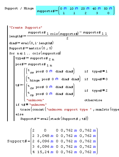

So if you want a built in constraint (i.e. Fixed), you would have a support (aka t.cw) and sym (aka t.cphi) at the same 'x' location (and thus the same node), correct?

You are right in how to make a fixed constraint. If you want to convey global parameters in a clean way, you might setup a list or vector of key=value pairs, hand that over as a regular input argument and evaluate them inside the function using Assign(). Didn't test this, but it might work.

Can you take a look at the attached (scroll down to you see big red text with "problem with cases". I seem to be having a problem with cases(). Maybe there is a better way in general to handle this situation.

Switch the optimization to numeric (use an eval when you are inside a loop), otherwise you can't mix numbers and strings...
moreover matrix(#,0) is not supported (0 columns) and is converted by SMath into a mat(#,0) - that is a broken mat() function

What is the best way to implement this. For some reason I can't seem grasp the best way to insert or remove rows from matrices (which is a big problem for most programs!)...
If I understand correctly the FEM beam function... to create a "Fixed" support I need to have a t.cw and a t.cphi at the same position. Therefore I need to create a new matrix with an extra support "type" at the same position. What is the best way to do this? See attached for portion of the routine that I am referring to.
Thanks!
Beam FEA - Support inserting into matrix.sm (8.87 KiB) downloaded 1262 time(s).
Thanks!

Well here it is. Not sure how stable it is as I have only limited testing. I wish the graph was easier to move around.
My next effort with be to allow multiple E, I inputs, but for now I will use this mostly for simple span beams.
I also want to create a "steel beam size optimization routine". The problem though is importing the steel beam sizes and properties. The matrix is just so large that it really slows the calculation down.
BeamFEA_1 Input-Result.sm (39.74 KiB) downloaded 1269 time(s).

They need to be used in the same work sheet. I've attached them in the same sheet. The idea is that the input and result can be used multiple times on a page, for multiple beams. In order to get the graph to work you must click on it, then right click, select template "T", right click again, select predefined layout "P". I actually don't use the graph, and am working on trying to track the reactions at the reactions (more on this later).
I seam to have left out the input graph (included in the attached)
Things still to impliment:
1. There are variables used in the functions which are still "dangerous" because they can be used outside of the function and cause errors. Namely I have found "l" (lower case "L") to be an issue.
2. Allow input for a change in E and I for different spans. I'm not sure the best way to setup input for this. Right now I really wanted something for simple beams.
BeamFEA Functions - Input and Result.sm (238.46 KiB) downloaded 1354 time(s).
