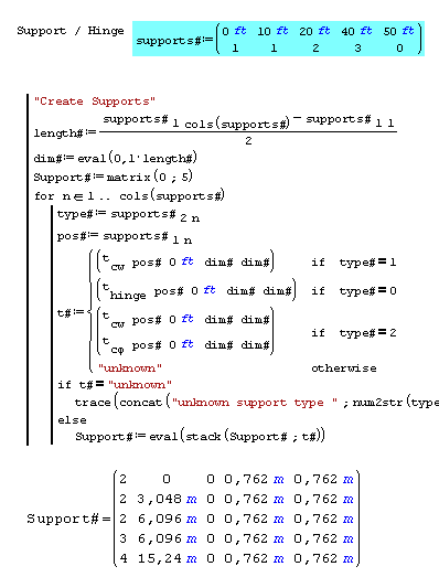

Can you take a look at the attached (scroll down to you see big red text with "problem with cases". I seem to be having a problem with cases(). Maybe there is a better way in general to handle this situation.
Thanks again for your help Martin.
FEA Beam - Decon - Preprocessor.sm (125,54 КиБ) скачан 1277 раз(а).
Switch the optimization to numeric (use an eval when you are inside a loop), otherwise you can't mix numbers and strings...
moreover matrix(#,0) is not supported (0 columns) and is converted by SMath into a mat(#,0) - that is a broken mat() function
About units, I think you may define "design base units (lenght/mass/force)" on the top of your worksheet, like in a common FEM program...
FEA Beam - Decon - Preprocessor.sm (127,77 КиБ) скачан 1330 раз(а).

Excuse me, but as an engineer your approach seems to me unnecessarily complicated
Why you don't use something like in the attachment? [you may also extend it with a 2nd if statement to check if the load is triangular]
Beam FEA - partial load cases.sm (35,77 КиБ) скачан 1254 раз(а).

I receive another odd error using cases.
First error - see attached, BEAM FEA - partial load cases_2
Second Error see attached, BEAM FEA - partial load cases_3
I suspect they are related but not sure how.

About the latest issues, the key is again the optimization. You have to set it to numeric (using eval() where you can't do it for some reason)
cases() is nothing else that an interface to a nested if/else structure. Because if/else is not supported by SMath's integrals, I've extended cases with a mathematical/boolean version of that nested structure; this is triggered when you choose the symbolic optimization. Thus If cases() with symbolic optimization contains elements that cannot be summable (matrices with different sizes, strings, etc), the summation fails and an error is returned.

What is the best way to implement this. For some reason I can't seem grasp the best way to insert or remove rows from matrices (which is a big problem for most programs!)...
If I understand correctly the FEM beam function... to create a "Fixed" support I need to have a t.cw and a t.cphi at the same position. Therefore I need to create a new matrix with an extra support "type" at the same position. What is the best way to do this? See attached for portion of the routine that I am referring to.
Thanks!
Thanks!
Beam FEA - Support inserting into matrix.sm (8,87 КиБ) скачан 1262 раз(а).
Thank you Martin!
Well here it is. Not sure how stable it is as I have only limited testing. I wish the graph was easier to move around.
My next effort with be to allow multiple E, I inputs, but for now I will use this mostly for simple span beams.
I also want to create a "steel beam size optimization routine". The problem though is importing the steel beam sizes and properties. The matrix is just so large that it really slows the calculation down.
BeamFEA_1 Input-Result.sm (39,74 КиБ) скачан 1269 раз(а).
RFreund, any instructions on how to use those files? I just get errors without changing any parameters, seems something is missing.
I will work on some instructions, sorry about this.
They need to be used in the same work sheet. I've attached them in the same sheet. The idea is that the input and result can be used multiple times on a page, for multiple beams. In order to get the graph to work you must click on it, then right click, select template "T", right click again, select predefined layout "P". I actually don't use the graph, and am working on trying to track the reactions at the reactions (more on this later).
I seam to have left out the input graph (included in the attached)
Things still to impliment:
1. There are variables used in the functions which are still "dangerous" because they can be used outside of the function and cause errors. Namely I have found "l" (lower case "L") to be an issue.
2. Allow input for a change in E and I for different spans. I'm not sure the best way to setup input for this. Right now I really wanted something for simple beams.
BeamFEA Functions - Input and Result.sm (238,46 КиБ) скачан 1354 раз(а).
