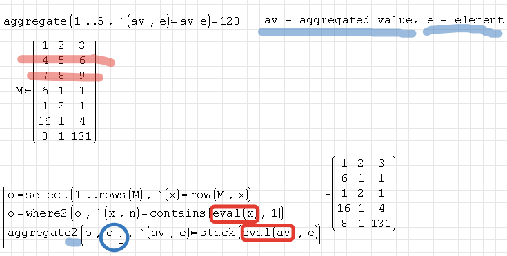

P.S. Here, the aggregate function is implemented not correctly.
Mike Kaganski 4/25/2014 8:16:00 AM

Updated. aggregate() - fixed.
Davide Carpi 4/25/2014 9:42:00 AM

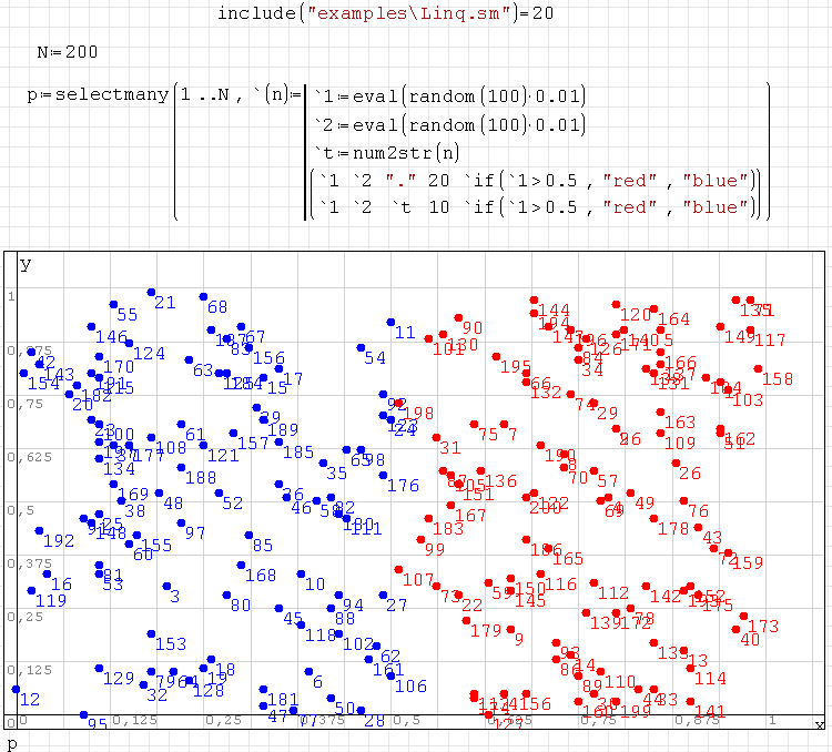

Unfortunatelly, nested queries not supported.
Davide Carpi 4/25/2014 6:24:00 PM, Radovan Omorjan 4/26/2014 2:42:00 AM

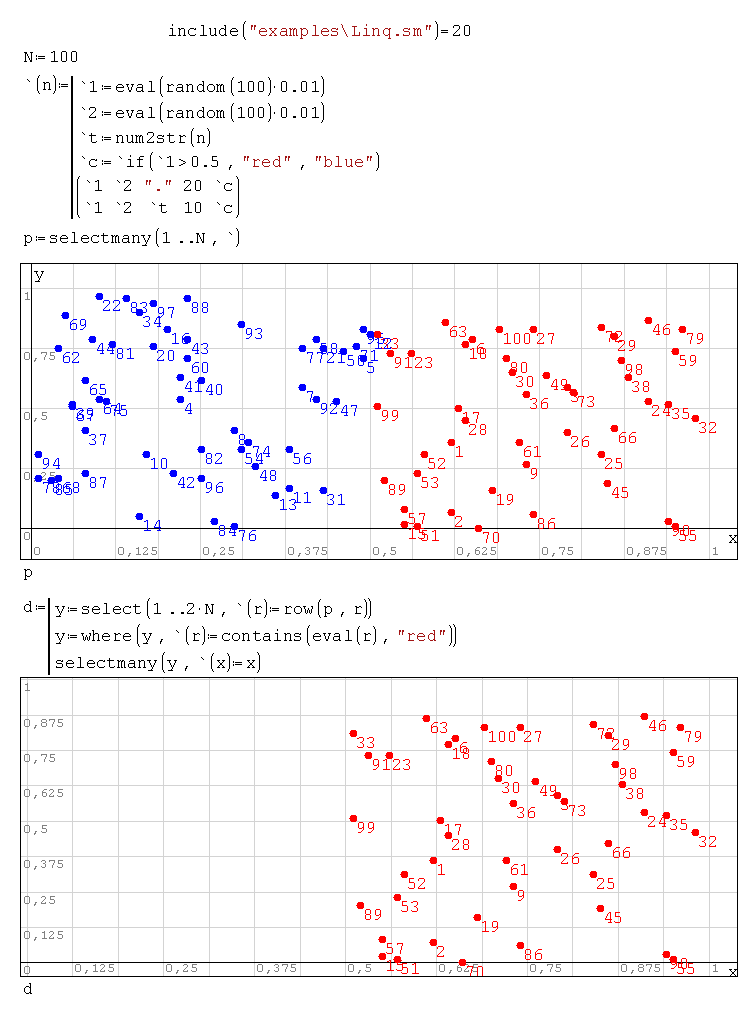

Plot example.
Linq. Plot.sm (7.04 KiB) downloaded 1312 time(s).

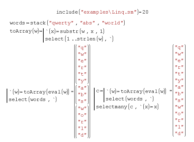

selectmany example.
Linq. selectmany.sm (7 KiB) downloaded 1286 time(s).

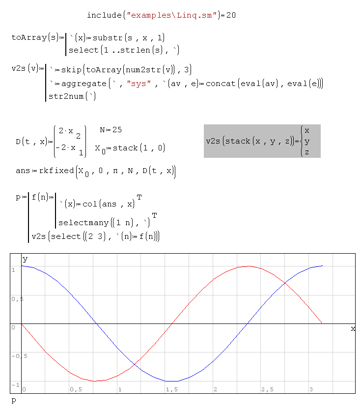

Linq. ODE plot.sm (10.3 KiB) downloaded 1329 time(s).

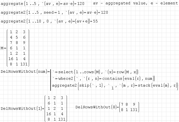

Updated. batch(2), batch(3) added.
Linq. batch.sm (9.34 KiB) downloaded 1332 time(s).
