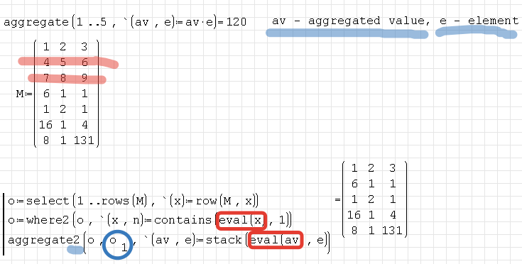

#6 Опубликовано: 25.04.2014 06:30:30
Updated. Small improvements.
P.S. Here, the aggregate function is implemented not correctly.
Mike Kaganski 25.04.2014 08:16:00

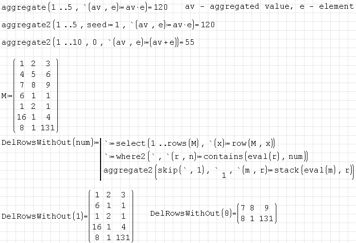

#8 Опубликовано: 25.04.2014 08:58:34
Updated. aggregate() - fixed.
Davide Carpi 25.04.2014 09:42:00

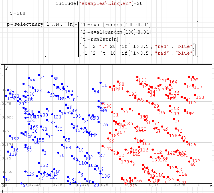

#12 Опубликовано: 25.04.2014 17:49:29
Updated.
Unfortunatelly, nested queries not supported.
Davide Carpi 25.04.2014 18:24:00, Radovan Omorjan 26.04.2014 02:42:00
#13 Опубликовано: 25.04.2014 18:57:58
Plot example.
Linq. Plot.sm (7,04 КиБ) скачан 1312 раз(а).
Radovan Omorjan 26.04.2014 02:42:00, Davide Carpi 25.04.2014 21:10:00

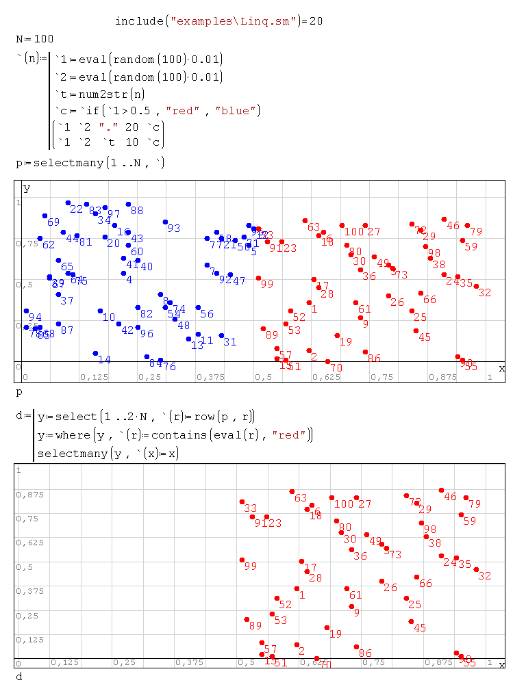

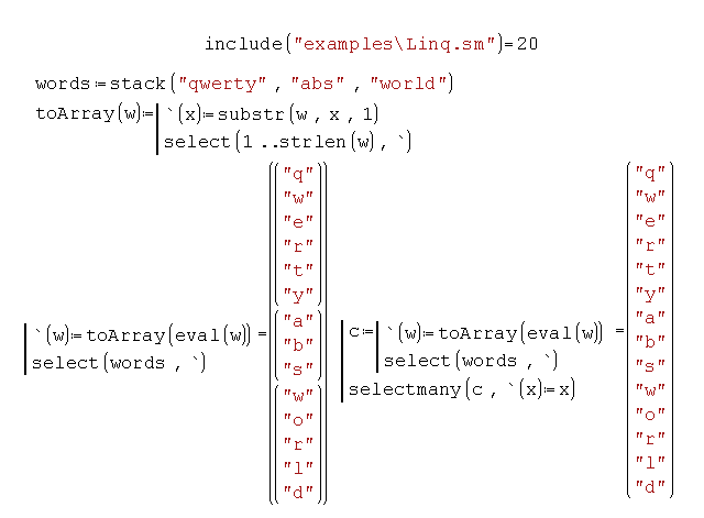

#14 Опубликовано: 25.04.2014 19:22:45
selectmany example.
Linq. selectmany.sm (7 КиБ) скачан 1286 раз(а).

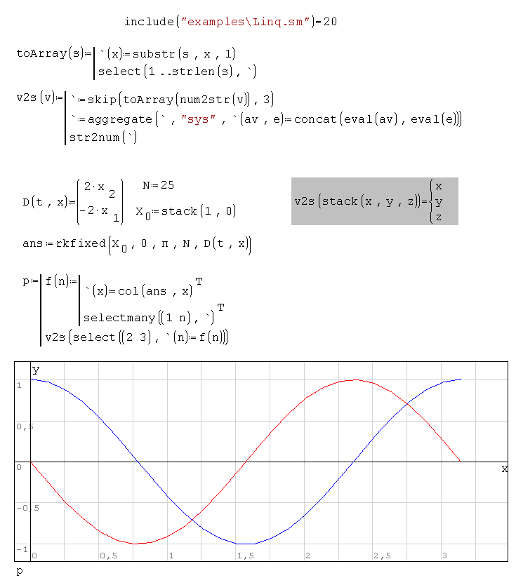

#15 Опубликовано: 25.04.2014 20:43:19
ODE plot.
Linq. ODE plot.sm (10,3 КиБ) скачан 1329 раз(а).
Radovan Omorjan 26.04.2014 02:43:00, Davide Carpi 25.04.2014 21:10:00
