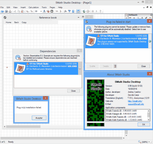

The EFI plugins for Smath Studio not start in version 0.98.6103 of Smath Studio.

Yes, I can't setup the assembly correctly. Do not use the latest builds. They marked as beta. I need a few days to solve the issue.

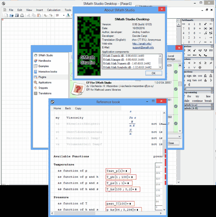

Updated. Try now.

Thank you very much, now, EFI Plugin load very good, but it does not work

And what about 32-bit flag? You can use CorFlags to set it manually.
