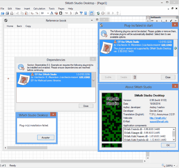

The EFI plugins for Smath Studio not start in version 0.98.6103 of Smath Studio.
#2 Опубликовано: 16.09.2016 13:47:22
Yes, I can't setup the assembly correctly. Do not use the latest builds. They marked as beta. I need a few days to solve the issue.

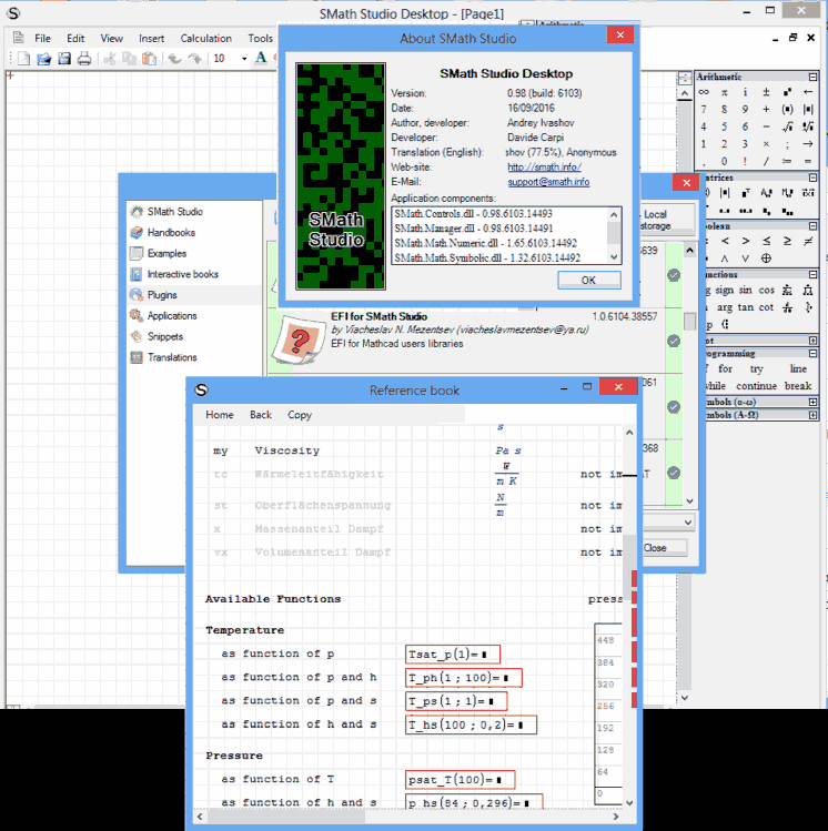

#3 Опубликовано: 18.09.2016 02:46:05
Updated. Try now.
#4 Опубликовано: 19.09.2016 15:31:09
CBG
CBG
Thank you very much, now, EFI Plugin load very good, but it does not work
Best Regards.
#5 Опубликовано: 19.09.2016 22:36:16
And what about 32-bit flag? You can use CorFlags to set it manually.
