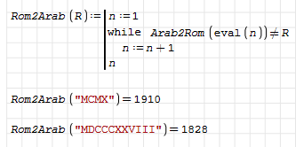

#1 Posted: 10/18/2023 10:06:10 PM
Valery Ochkov
Valery Ochkov
67 likes in 716 posts.

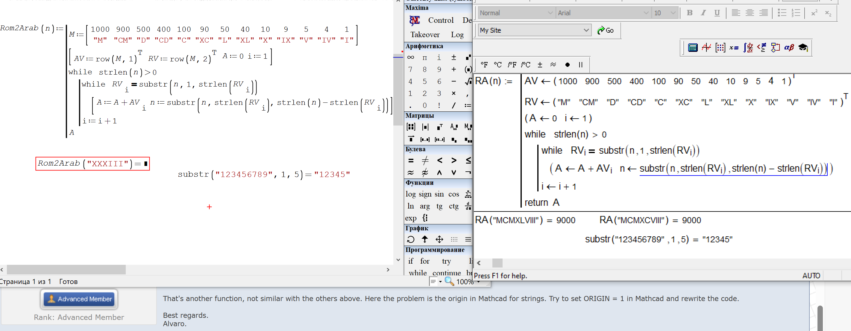

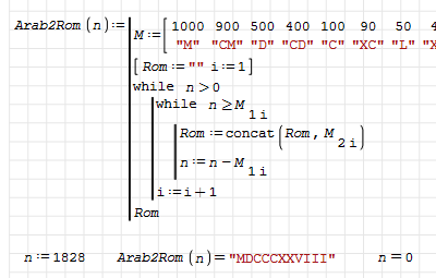

Why doesn't the cycle end?
See please the attachRome-Arab.sm (40.3 KiB) downloaded 1539 time(s).

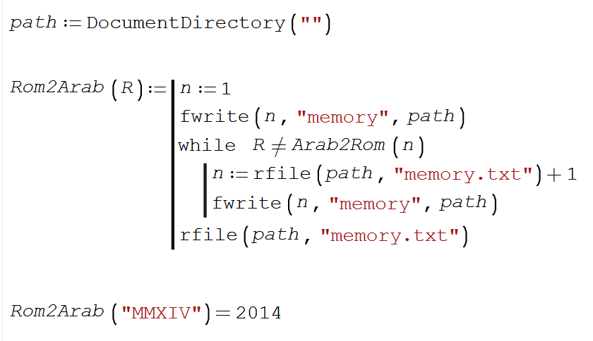

#2 Posted: 10/19/2023 12:53:00 AM
Oscar Campo
Oscar Campo
135 likes in 309 posts.
Really it's a very strange bahavior (a bug ?), because the value of variable n is cleared when function returns from Arab2Rom()
So, a solution is to use functions fwrite() and rfile() to save the value of n on a file as a memory:
See the atachment with the solution: Rome-Arab SOLVED.sm (41.21 KiB) downloaded 1549 time(s).
best,
Oscar
Valery Ochkov 10/19/2023 1:08:00 AM
#3 Posted: 10/19/2023 1:30:20 AM
1,139 likes in 1,805 posts.
Hi. In Arab2Rom(n) you modify n.
That's not good practice. This is a workaround for such cases.
Valery Ochkov 10/19/2023 1:46:00 AM, Oscar Campo 10/19/2023 1:46:00 AM
#4 Posted: 10/19/2023 1:42:23 AM
Valery Ochkov
Valery Ochkov
Thanks!
But this have an error too!
Rom2Arab.sm (293.29 KiB) downloaded 1529 time(s).

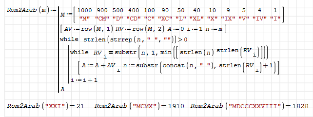

#5 Posted: 10/19/2023 1:52:56 AM
Thanks!
That's another function, not similar with the others above. Here the problem is the origin in Mathcad for strings. Try to set ORIGIN = 1 in Mathcad and rewrite the code.

#7 Posted: 10/19/2023 2:43:57 AM
This is one way.
Valery Ochkov 10/19/2023 2:49:00 AM

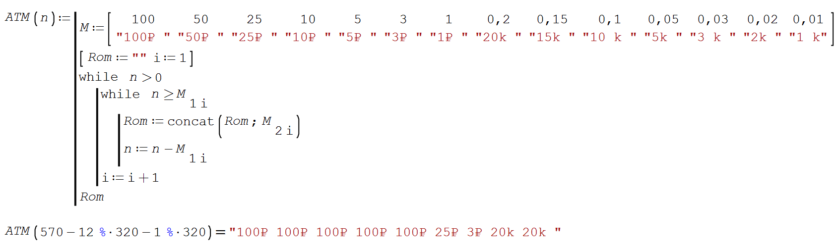

#9 Posted: 10/23/2023 12:30:24 AM
Valery Ochkov
Valery Ochkov
My salary in 1980
ATM-SU.sm (6.29 KiB) downloaded 1535 time(s).
#10 Posted: 10/23/2023 1:34:42 AM
1,362 likes in 2,276 posts.
If I remember correctly, 1988 a bottle of vodka (0.5l) was 3 rubles (if you got it at all, it was the time of prohibition - сухой закон). Therefore the 3-ruble-notes.
Valery Ochkov 10/23/2023 2:31:00 AM

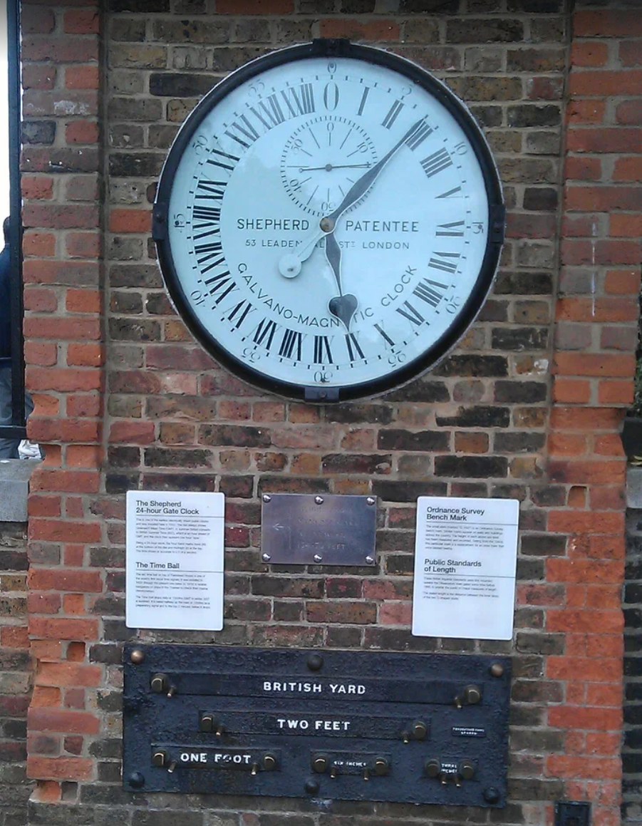

#12 Posted: 10/28/2023 4:11:54 PM
Valery Ochkov
Valery Ochkov
There are also zeros in Roman numerals. See my photo from Greenwich.
And four is written this way IIII and not that way IV because there are only 12 and not 13 digits.
