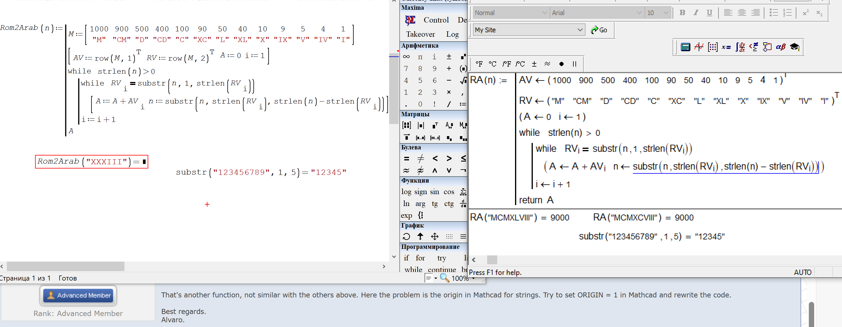

Why doesn't the cycle end?
See please the attachRome-Arab.sm (40,3 КиБ) скачан 1527 раз(а).

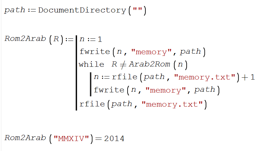

Really it's a very strange bahavior (a bug ?), because the value of variable n is cleared when function returns from Arab2Rom()
So, a solution is to use functions fwrite() and rfile() to save the value of n on a file as a memory:
See the atachment with the solution: Rome-Arab SOLVED.sm (41,21 КиБ) скачан 1532 раз(а).

Hi. In Arab2Rom(n) you modify n.
That's not good practice. This is a workaround for such cases.

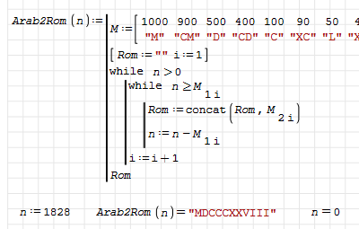

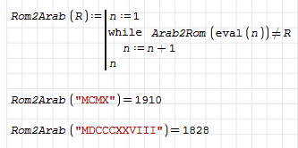

But this have an error too!

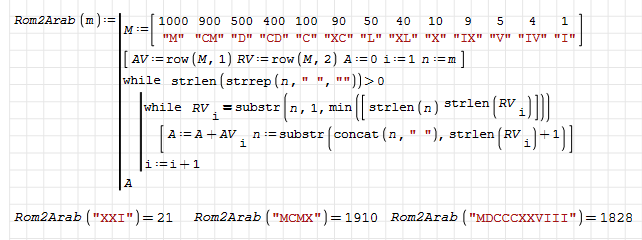

Rom2Arab.sm (293,29 КиБ) скачан 1514 раз(а).

That's another function, not similar with the others above. Here the problem is the origin in Mathcad for strings. Try to set ORIGIN = 1 in Mathcad and rewrite the code.

This is one way.
Valery Ochkov 19.10.2023 02:49:00

This is one way.
Thanks,
send please the sm-file!

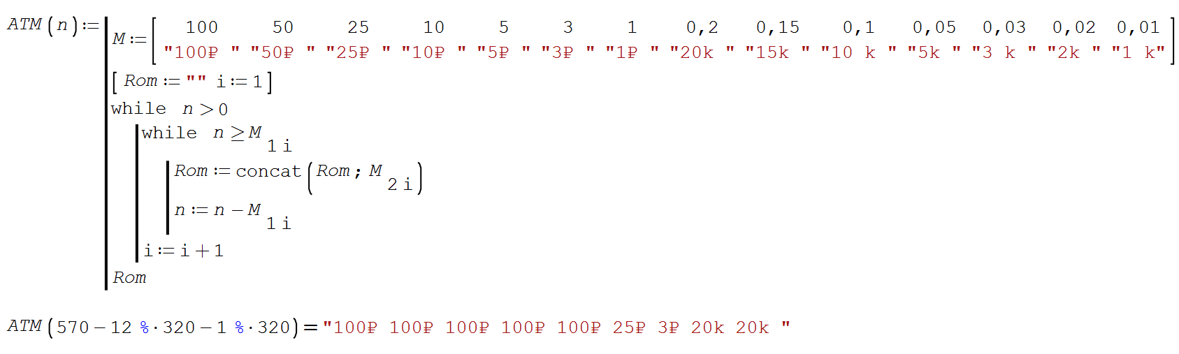

My salary in 1980
ATM-SU.sm (6,29 КиБ) скачан 1524 раз(а).
#10 Опубликовано: 23.10.2023 01:34:42
If I remember correctly, 1988 a bottle of vodka (0.5l) was 3 rubles (if you got it at all, it was the time of prohibition - сухой закон). Therefore the 3-ruble-notes.

2 рубля 87 копеек = 2.75 vodka + 0.12 bottle.
Three constants of soviet students 3.14, 2.87, 2.72

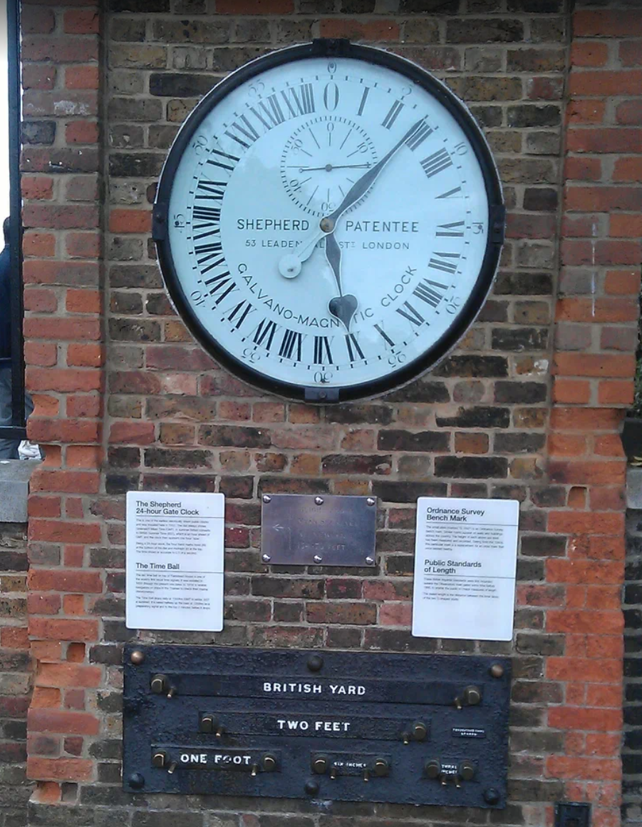

And four is written this way IIII and not that way IV because there are only 12 and not 13 digits.
