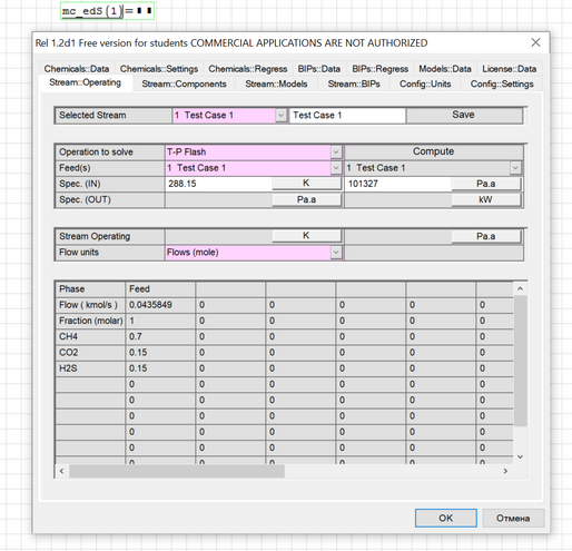

Procedure:
1. Calculate the entire worksheet, ctrl-F9
2. Select dep.ppp archive when first window appears, and click Open
3. When second popup window, the Prode archive, appears, it should show stream 2. Click OK.

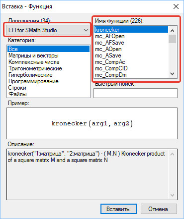

I added the ppp.dll to userefi folder, but only kronecker and Psi show in the function list for EFI. I have restarted the SMath program and also disabled EFI and then enabled it an still no mc_xxxx functions.
I created the test_ppp file so I know how to use it.

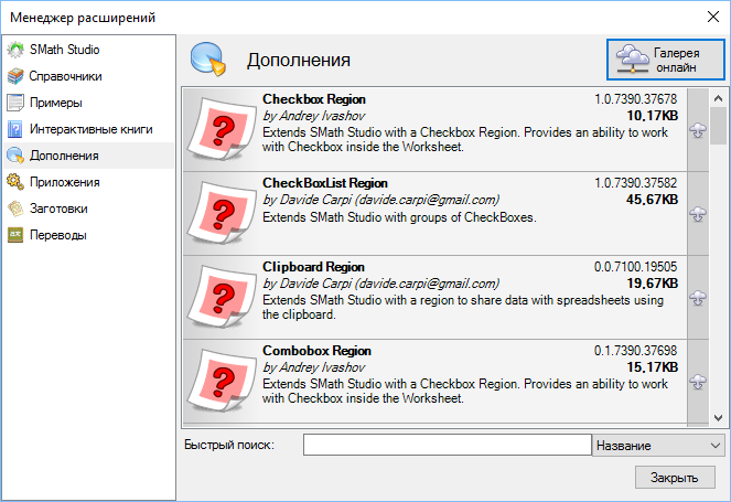

Reopen I mean, try to reinstall the plugin using the Extension manager.
The default path for plugin is: C:\Users\%user_name%\Application Data\SMath\extensions\plugins\91a20d24-c30b-4774-9b1b-4d502a80420f\x.x.x.x\

It is not recommended to use SMath Studio\plugins folder. For a standard installation of the program, all extensions are installed in the above path.
As I can see, you are using an old version of the plugin (1.0.6982.32016, Tuesday, February 12, 2019 5:47:12 PM).
The last version is: 1.0.7165.40625, 14-aug-2019 22:34:10
I don't know why you are using SMath Studio\plugins folder. Try to download last SMath Studio and install the plugin in standard way - using Extension manager in main menu.
After that - copy dlls to the plugin directory (not SMath Studio\plugins). Reopen the program and show me also \userefi\efi.txt file.

Here's the actual path where I found the plugins. C:\Users\Harvey\AppData\Roaming\SMath\extensions\plugins
Here's the path where my SMath program is currently installed: C:\Program Files (x86)\SMath Studio
As I recall, I only got to say where the program was to be installed, not the plugins.
Before I start the re-installation process, I have a question: By Extension manager do you mean tools>plugins? I see no Extension manager.

The GOOD NEWS: Prode Phys. Properties works! The functions appear in the function list and the test file opens. There were some errors but I may be able to fix those. It appears that one problem is the SMath program doesn't recognize disabled math statements. That could explain some of the errors.
