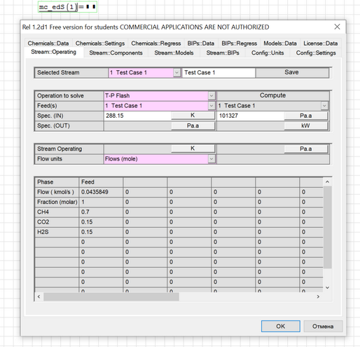

You must copy ppp.dll and prode.dll to the userefi folder and restart the program. After that you must point to some location when document opened.
Procedure:
1. Calculate the entire worksheet, ctrl-F9
2. Select dep.ppp archive when first window appears, and click Open
3. When second popup window, the Prode archive, appears, it should show stream 2. Click OK.
I don't have this archive and this folder and I no longer remember what it is for. But now all functions are accessible.

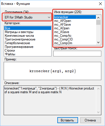

I added the ppp.dll to userefi folder, but only kronecker and Psi show in the function list for EFI. I have restarted the SMath program and also disabled EFI and then enabled it an still no mc_xxxx functions.

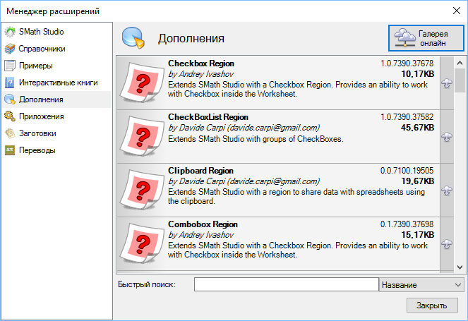

#10 Опубликовано: 30.05.2020 14:28:45
Reopen I mean, try to reinstall the plugin using the Extension manager.
The default path for plugin is: C:\Users\%user_name%\Application Data\SMath\extensions\plugins\91a20d24-c30b-4774-9b1b-4d502a80420f\x.x.x.x\

Before I start the re-installation process, I have a question: By Extension manager do you mean tools>plugins? I see no Extension manager.
#15 Опубликовано: 30.05.2020 16:44:57
Using this window

As I can see, you are using an old version of the plugin (1.0.6982.32016, Tuesday, February 12, 2019 5:47:12 PM).
The last version is: 1.0.7165.40625, 14-aug-2019 22:34:10
My version of the EFI plugin is the latest that the installer provides.
The GOOD NEWS: Prode Phys. Properties works! The functions appear in the function list and the test file opens. There were some errors but I may be able to fix those. It appears that one problem is the SMath program doesn't recognize disabled math statements. That could explain some of the errors.
