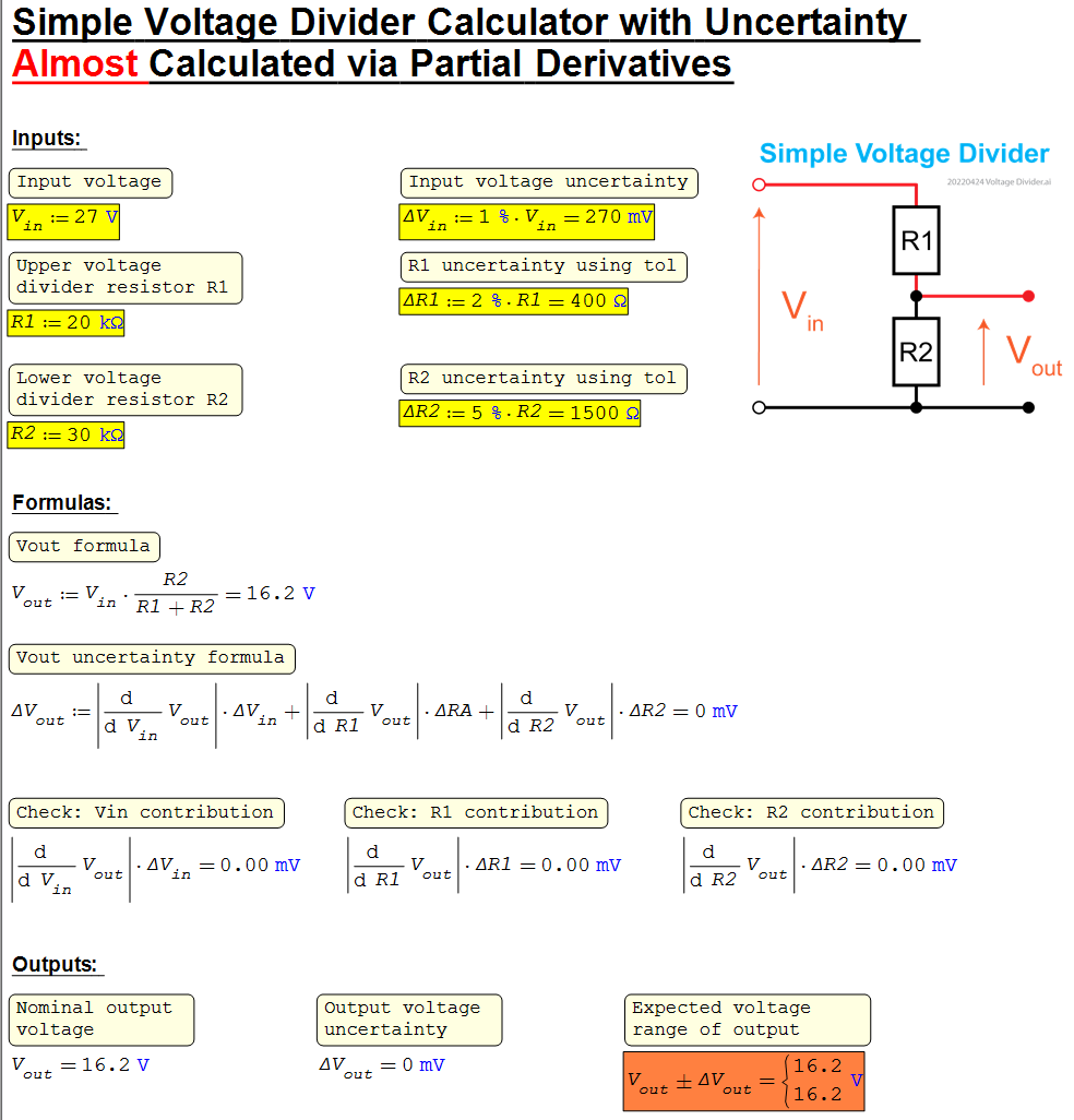

Estimating Voltage Divider Uncertainty with Partial Derivatives: Something Missing - Messages
20220424 Simple Voltage Divider with Tolerances A3.sm (56.75 KiB) downloaded 1332 time(s).
Thank you in advance.

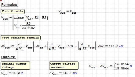

The technical solution: Use V.out(V.in,R1,R2) instead V.out. The only problem is that this way the expression for calculating the error is very long, visually.
The intermediate solution: unassign the variable "inside" the definition of V.out.
The main reason: like in mathcad, in smath the numerical derivation does not follow the usual rules of evaluation and does what is "Hold" in wolfram mathematica and "uneval" in maple.

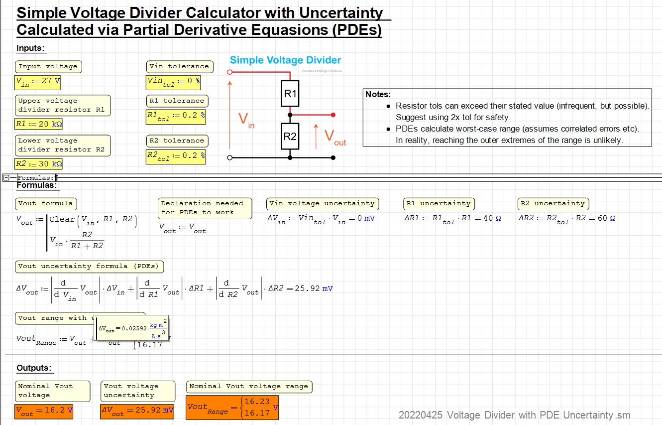

Thank you Alvaro. All about using the right tools for the job, and learning that as we learn more, we need to learn more... without getting paralyzed (the 'good enough' theorem).
I'm using the PDEs as they provide a 'safely over-stated outer bounds' for worst-case circuit design (ie all errors correlated, all absolute vector magnitudes added linearly (ie not Euclidean) which they don't in real-world applications). For my current application, this 'overstatement' of error uncertainty is fine. With more constrained designs I'd have to look at the error distributions, correlations, and confidence intervals (thank you for the uncertainty 'bible'!), and even adjust-on-test, calibration etc (eek).

20220425 Voltage Divider with PDE Uncertainty.sm (59.27 KiB) downloaded 1355 time(s).
