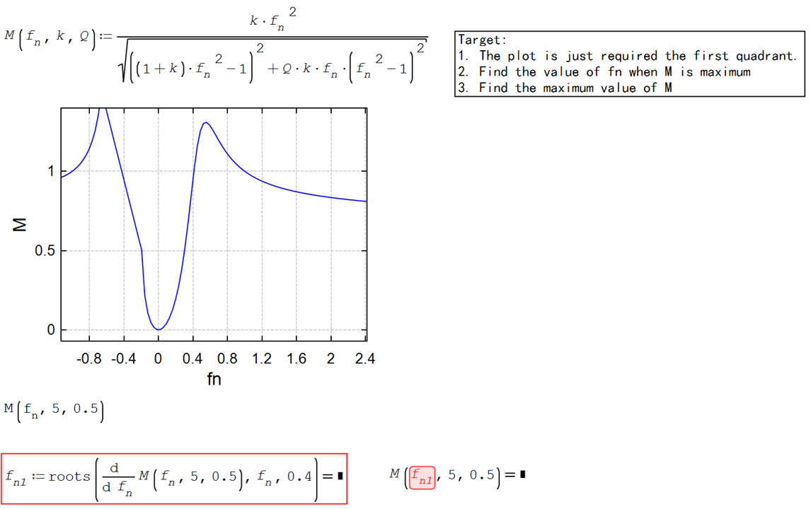

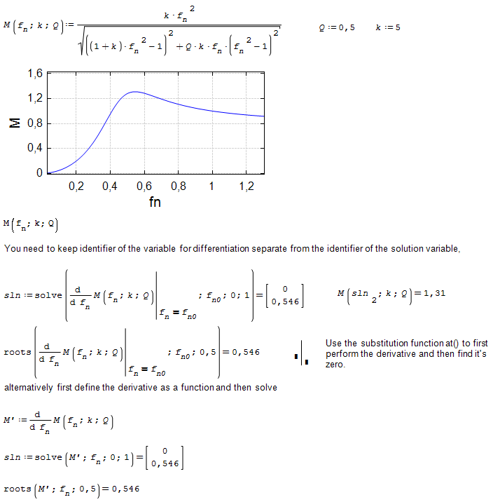

Hi, guys:
Here is a formula
And the Targets are:
1. Draw the plot, but only the first quadrant is required.
2. Find the value of fn when M is maximum.
3. Find the maximum value of M.
I did the 1st target successfully, but can not find the values of fn and M. I have tried my best and search the forum but could not find any way to fix it. Please help to fix it, Thank you very much!
LLC.sm (12.37 KiB) downloaded 1335 time(s).

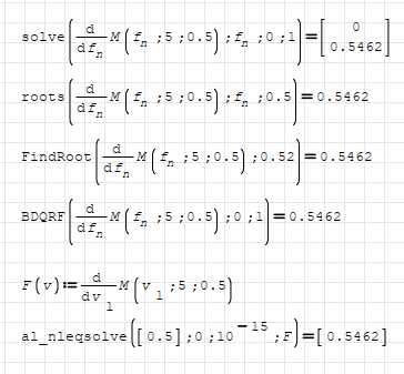

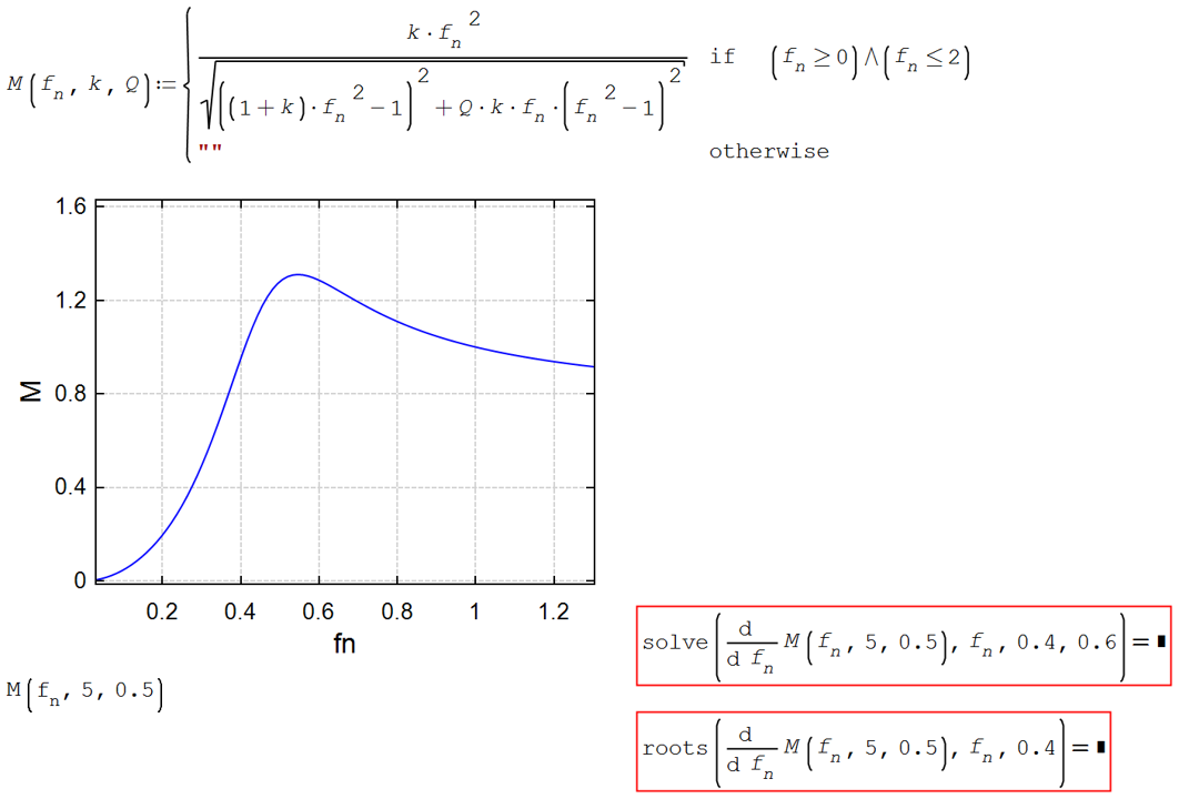

#3 Posted: 2/25/2023 2:41:41 PM
1,362 likes in 2,276 posts.
The built-in functions are perfectly well suited for the purpose. You just need to separate differentiation from root finding.
LLC.sm (11.01 KiB) downloaded 1308 time(s).

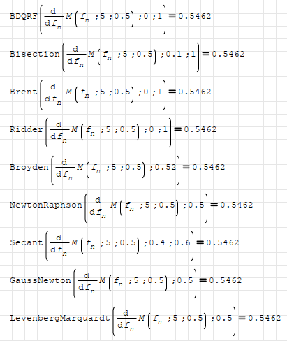

#5 Posted: 2/26/2023 8:58:40 PM
600 likes in 1,381 posts.
Here is your functions peak point solved with various solvers.
LLC1.sm (9.33 KiB) downloaded 1326 time(s).

#7 Posted: 2/27/2023 11:13:37 PM
Apart from Findroot() there are other functions in Nonlinear Solvers to.
Check that plugins page in Reference Book, there may some info you can use.
LLC1.sm (13.8 KiB) downloaded 1337 time(s).
