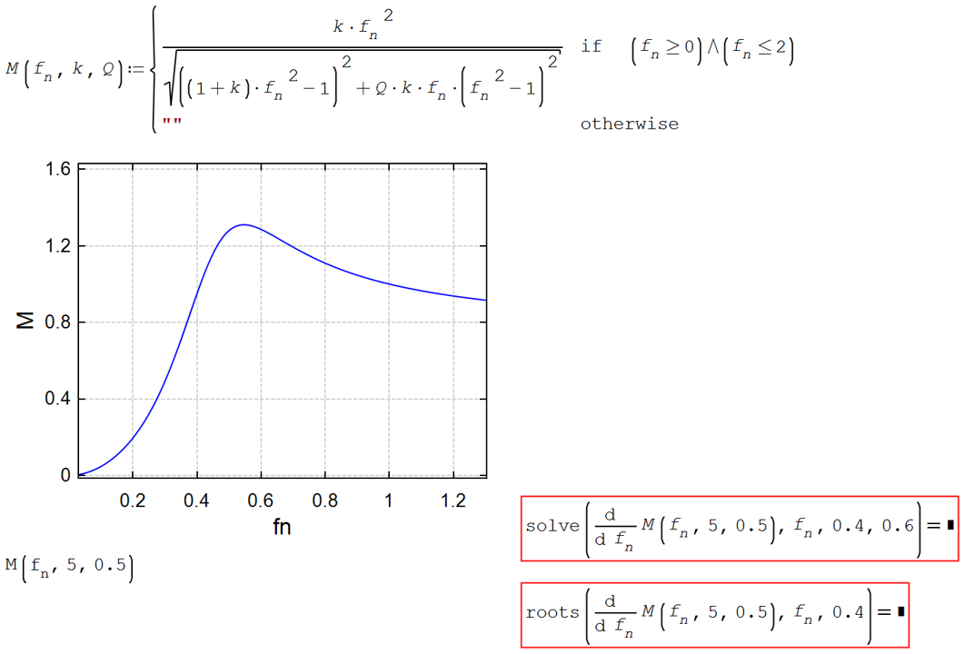

Hi, guys:

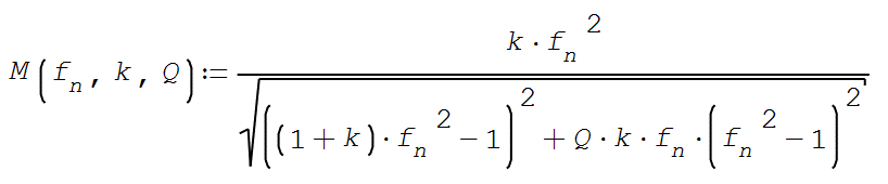

Here is a formula
And the Targets are:

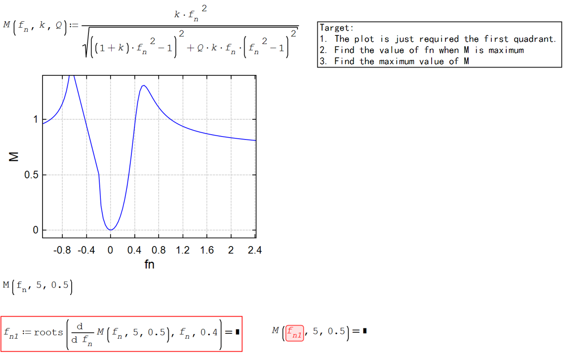

1. Draw the plot, but only the first quadrant is required.
2. Find the value of fn when M is maximum.
3. Find the maximum value of M.
I did the 1st target successfully, but can not find the values of fn and M. I have tried my best and search the forum but could not find any way to fix it. Please help to fix it, Thank you very much!

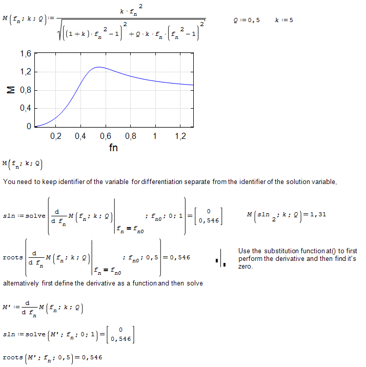

The built-in functions are perfectly well suited for the purpose. You just need to separate differentiation from root finding.
LLC.sm (11,01 КиБ) скачан 1308 раз(а).
sergio 25.02.2023 16:40:00, João Felipe Seráfico Melo 26.02.2023 06:38:00

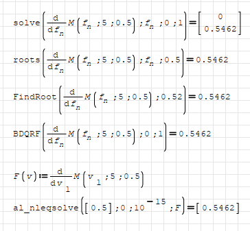

Here is your functions peak point solved with various solvers.
LLC1.sm (9,33 КиБ) скачан 1326 раз(а).

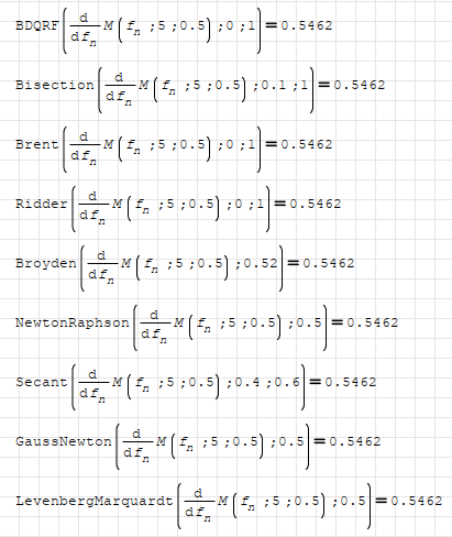

#7 Опубликовано: 27.02.2023 23:13:37
Apart from Findroot() there are other functions in Nonlinear Solvers to.
Check that plugins page in Reference Book, there may some info you can use.
LLC1.sm (13,8 КиБ) скачан 1337 раз(а).
