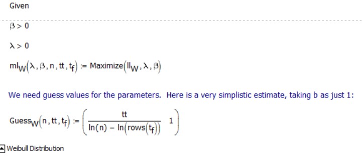

I have tried to convert the attached MC15 worksheet to SMATH. I cannot work around the solve block (Maximize) successfully. I welcome the collabs review and recommendation(s).

#2 Posted: 9/7/2018 2:19:42 PM
Norm Schutzkus
Norm Schutzkus
9 likes in 90 posts.
The solve block is in the "Weibull Distribution" area (collapsed).
nas

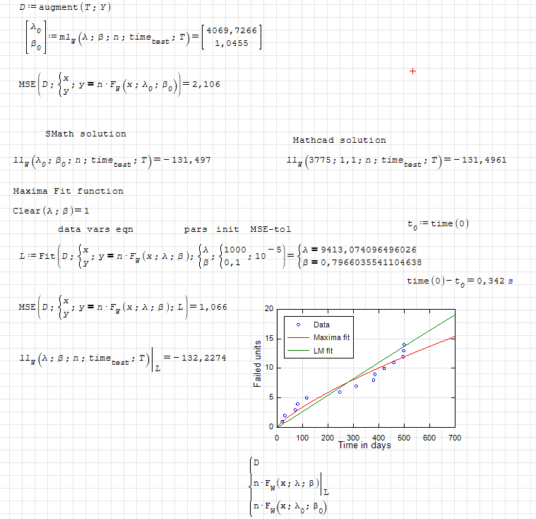

#9 Posted: 9/10/2018 6:20:39 AM
1,362 likes in 2,276 posts.
Fit using Maxima's lsquares package. MSE() is the mean square error, which is minimized by Fit()
2018-09-10 11_11_54-SMath Studio 0.99.6671 - [Chain%20Failure%20Weibull%20Analysis%20-%203.sm_].png
Chain%20Failure%20Weibull%20Analysis%20-%203_Kr.sm (78.46 KiB) downloaded 1368 time(s).
frapuano 9/10/2018 9:23:00 AM
