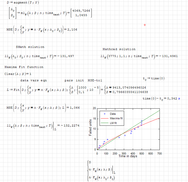

I have tried to convert the attached MC15 worksheet to SMATH. I cannot work around the solve block (Maximize) successfully. I welcome the collabs review and recommendation(s).

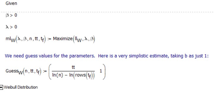

The solve block is in the "Weibull Distribution" area (collapsed).

Fit using Maxima's lsquares package. MSE() is the mean square error, which is minimized by Fit()
2018-09-10 11_11_54-SMath Studio 0.99.6671 - [Chain%20Failure%20Weibull%20Analysis%20-%203.sm_].png
Chain%20Failure%20Weibull%20Analysis%20-%203_Kr.sm (78,46 КиБ) скачан 1368 раз(а).
