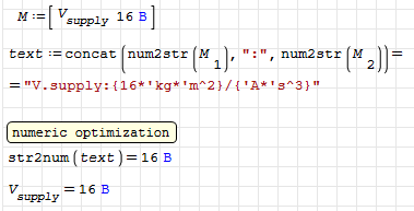

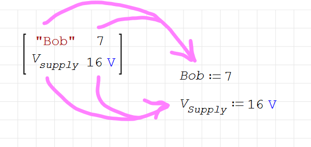

Is there a function or method that would allow a string (or variable name) located in a matrix element to be used as the name to define a variable?
Something like this:
Thank you!
#2 Posted: 12/31/2022 4:28:45 AM
1,558 likes in 1,868 posts.
4 users liked this post
Mark R Harris 12/31/2022 6:43:00 AM, NDTM Amarasekera 12/31/2022 10:10:00 AM, overlord 1/1/2023 3:20:00 PM, sergio 12/31/2022 8:09:00 AM
#3 Posted: 12/31/2022 6:43:07 AM
Mark R Harris
Mark R Harris
5 likes in 90 posts.
Thank you so much uni!

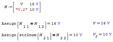

You can also use the Assign() function of the Maxima Plugin (this should work even without Maxima installed).
It converts boolean equations into assignments.
In the case of strings you still need to apply str2num()

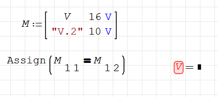

Some odd behavior here. When the "=" evaluation is removed the Assign() function breaks:
Assign odd behaviour.sm (3.14 KiB) downloaded 1333 time(s).
Any thoughts?

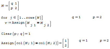

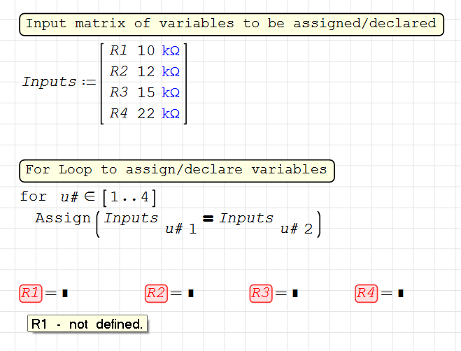

I'm hoping to be able to assign multiple variables from a matrix like this:
Assign For Loop Broken.sm (5.11 KiB) downloaded 1292 time(s).

a small workaround, could be to place the for inside a line command and return a false token value, it is not very clean but it works as far as I can see.
I think the assign command is not evaluated immediately, but has a delayed evaluation, which somehow only takes place after using the "=" symbol.
Two hints:
- The Assign function needs to be executed in order to do it's work, either by assigning the result to some dummy variable or by requesting display of the result.
- You don't need a loop, Assign() can handle vector arguments
Blatt10.sm (5.31 KiB) downloaded 1377 time(s).

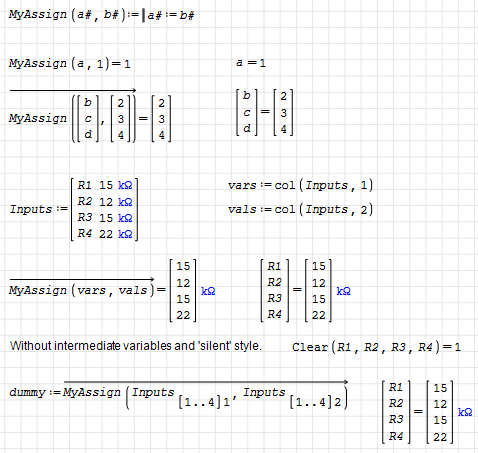

Hi. This could be another option.
MyAssign 2.sm (10.52 KiB) downloaded 1353 time(s).

@Razonar, as usual with you, you give imaginative and useful solutions, it's great when people share their knowledge and help others, and with such a high technical level. thanks and congratulations.
I have a folder on my computer exclusively for the spreadsheets you share.
