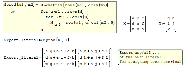

WroteSomething is wrong here, in both MProd functions, but can't figure what is it.

WroteHi. Something is wrong here, in both MProd functions, but can't figure what is it.

Hello Alvaro, I can't explain the problem, but I see that it originates from the way arguments are passed to MDot.
See attachment, writing arguments directly into MDot gives correct result, passing through row() and col() gives an "a not defined" error.
It seems that using row() and/or col() a numerical evaluation is triggered, even if the region is marked as "Symbolic".
Sorry, I can't give a better explanation.
Marco

WroteHello Alvaro, I can't explain the problem, but I see that it originates from the way arguments are passed to MDot.
Marco

Hi Marco. Thanks very much for your appointments. I go to take them in consideration for see the best way to extend dot product for some simple manipulations with symbolic algebra and taking the conjugate transpose instead the second argument.
Marco
Hi. Enogh to know that problem it's in row and col functions. Even I can't write the code for them, seems to be solved the issue rewriting length function.

WroteEven I can't write the code for them,
Alvaro ... is that what you are looking for ?
Utilities Matrix Product[X,Y].sm (16.63 KiB) downloaded 1254 time(s).
mprod_workaround.sm (7.99 KiB) downloaded 1455 time(s).
Same solution it's used for Lagrange equations with vectors.
