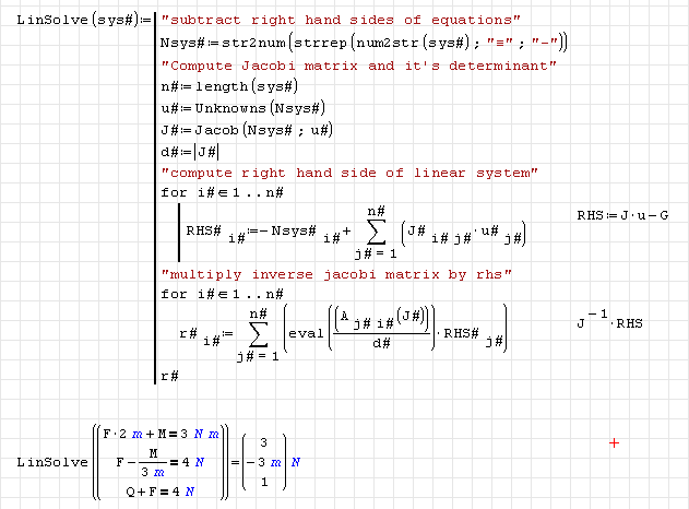

#143 Posted: 8/4/2013 6:21:04 PM
1,361 likes in 2,275 posts.
Here is a proposal for a unit-proof and user-friendly linear solver.
Davide, I propose to include it in the NonLinearSolvers plugin, perhaps as FindRoot(1).
- Equations can be specified using boolean equal with arbitrary distribution of linear and absolute terms to left and right hand side
- equations and unknowns can have arbitrary and different units
- no need for initial guess
- no need for specification of result units
I was not able to reproduce the embedded assignment feature in the example procedure. I would propose to enable that by default and perhaps provide an optional assignment flag.
Also, a linearity check (e.g. hessian-based) might be sensible.
The procedure LinSolve() looks more cumbersome than it ought to be, because of unreliable symbolic matrix inversion and multiplication. Fortunately, the alg() function works and thus the inverse can be computed with moderate coding effort.
LinSolve() provides an alternative for "hand made" sparse linear systems, as they typically occure in basic engineering mechanics. For densly populated systems, the matrix notation of the system might be more appropriate.

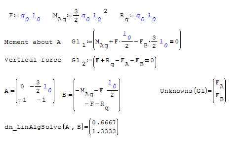

#151 Posted: 9/12/2013 3:58:05 AM
Thank you Martin for this,
It is interesting to note that FindRoot() would take a considerable time to solve it with the appropriate initial guess (about 2min on my comp). I have no idea why FindRoot() gave the wrong results with some other initial guess (hope that Davide will find the problem). I also tried DotNumeric solver - see the picture please. The difference is regarding "units like variables" (no units here). The result might not be considered correct, and regarding that this is a numerical solver, I have no idea how dn_LinAlgSolve() escaped from this.

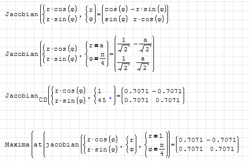

#154 Posted: 11/11/2013 5:36:24 PM
Why not Jacobian(), Jacobian.CD() from this plugin?
#155 Posted: 11/11/2013 6:10:10 PM
Because I just wanted to fill the gaps of the active book function reference. I had the impression from the test file that the function was meant to handle vector functions. Davide, correct me if that is wrong.
#156 Posted: 11/11/2013 6:39:55 PM
Yes, you are right about the test file (Gradient_testing.sm). I did not remember this in the first place, but guessed there must be a reason you asked about it

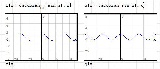

#159 Posted: 12/2/2013 8:02:24 PM
Jacobian.CD seems to be unstable.
Davide, do you have any valid test or demo file, describing the expected functions?
#160 Posted: 12/3/2013 8:48:22 AM
Thank you Martin,
you are right, I'll try to fix it...
