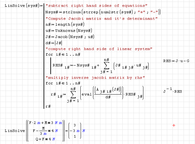

Here is a proposal for a unit-proof and user-friendly linear solver.
Davide, I propose to include it in the NonLinearSolvers plugin, perhaps as FindRoot(1).
- Equations can be specified using boolean equal with arbitrary distribution of linear and absolute terms to left and right hand side
- equations and unknowns can have arbitrary and different units
- no need for initial guess
- no need for specification of result units
I was not able to reproduce the embedded assignment feature in the example procedure. I would propose to enable that by default and perhaps provide an optional assignment flag.
Also, a linearity check (e.g. hessian-based) might be sensible.
The procedure LinSolve() looks more cumbersome than it ought to be, because of unreliable symbolic matrix inversion and multiplication. Fortunately, the alg() function works and thus the inverse can be computed with moderate coding effort.
LinSolve() provides an alternative for "hand made" sparse linear systems, as they typically occure in basic engineering mechanics. For densly populated systems, the matrix notation of the system might be more appropriate.
I agree with you completely . Your solution is quite educative and very interesting. A linear solver of this kind would be rather appreciated. We are also aware of unreliable Jacobian (derivatives) calculation, matrix inverse etc. Nevertheless, classical nonlinear solver approach could stuck if you give the linear system and try to force it in a nonlinear fashion. I suppose that you gave the idea to Davide how to make a basically linear solver. I just would like if there would be a possibility to incorporate into the solvers some kind of linearity check, like you said, and the option to solve it as a linear problem.

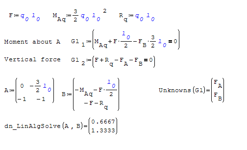

#150 Опубликовано: 11.09.2013 17:11:44
I found an example, where FindRoot() silently returns a solution that by far does not solve the given equations. It is ok that the solution may depend on initial values. In the given case, however, there is only a single solution and the wrong result is not converged. I have no idea what causes the problem. Setting tight error limits does not help.
Example Linsolve Beam2.sm (21,71 КиБ) скачан 1622 раз(а).
Radovan Omorjan 12.09.2013 03:30:00, Davide Carpi 11.09.2013 17:53:00
#151 Опубликовано: 12.09.2013 03:58:05
Thank you Martin for this,
It is interesting to note that FindRoot() would take a considerable time to solve it with the appropriate initial guess (about 2min on my comp). I have no idea why FindRoot() gave the wrong results with some other initial guess (hope that Davide will find the problem). I also tried DotNumeric solver - see the picture please. The difference is regarding "units like variables" (no units here). The result might not be considered correct, and regarding that this is a numerical solver, I have no idea how dn_LinAlgSolve() escaped from this.
#152 Опубликовано: 12.09.2013 15:46:27

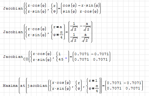

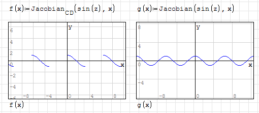

#159 Опубликовано: 02.12.2013 20:02:24
Jacobian.CD seems to be unstable.
Davide, do you have any valid test or demo file, describing the expected functions?
#160 Опубликовано: 03.12.2013 08:48:22
Thank you Martin,
you are right, I'll try to fix it...
