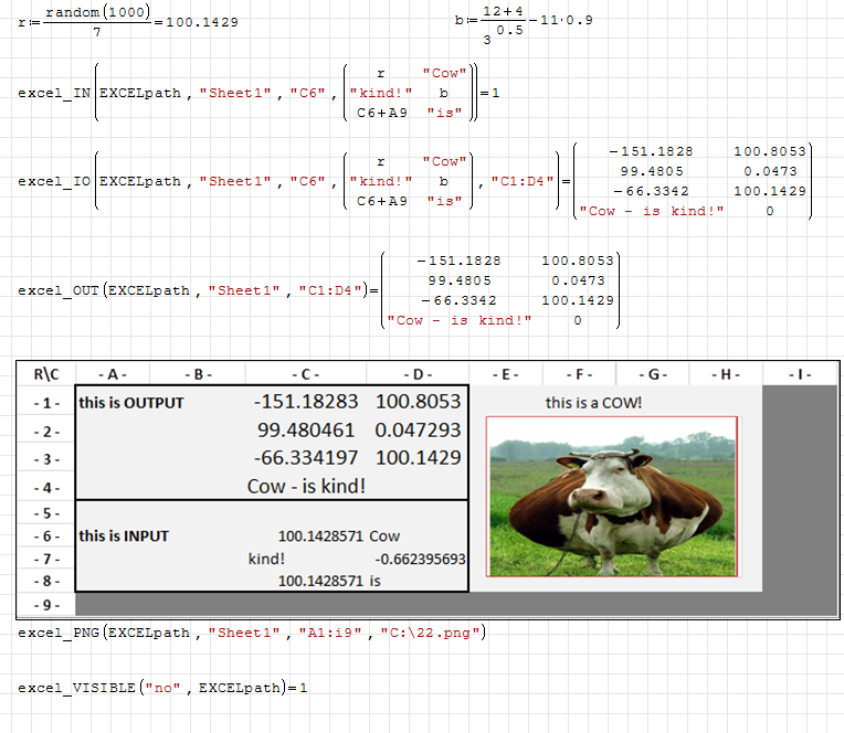

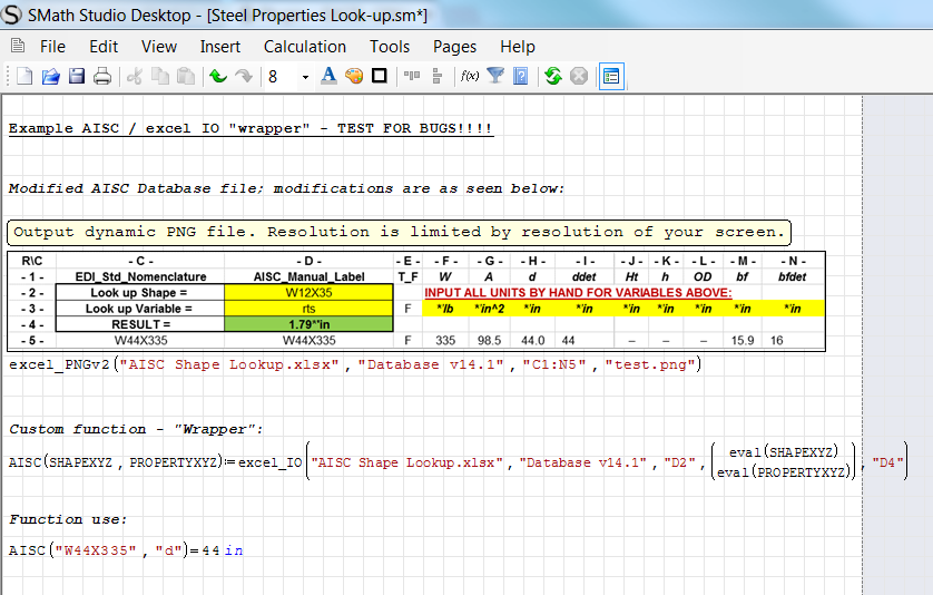

One of the ways to use plugin:
1. Insert image region into SMath workbook for visual confirmation of SMath <-> EXCEL interaction. Use excel_PNGv2 as an argument of the image region, point it to the range you would like to modify in your xls file. NOW YOUR EXCEL WORKBOOK IS OPEN IN BACKGROUND (this step is optional, however handy to visualize your input)
2. Once you visually see the screenshot of your excel file (together with row/column headers) you can use excel_IN to modify particular cells of the file.
3. Insert image region into SMath workbook that refers to your desired output range in xls file (similar to 1, this step is optional, however handy to visualize your output)
4. Use excel_OUT to point to particular cells/ranges in xls file (once you visually identify them from image region).
If you come up with an idea of what my plugin can potentially do (and it hypothetically should be able to do anything EXCEL does), post it below!

A sample of a Plot produced by combination of excel_EMF function and Image Region inside the SMath workbook.
The example was borrowed from one of the calculations by Jean Giraud.
Note the difference of as-printed quality between X-Y Plot output and excel_EMF output.

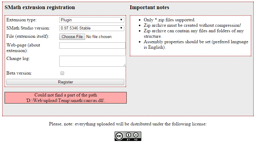

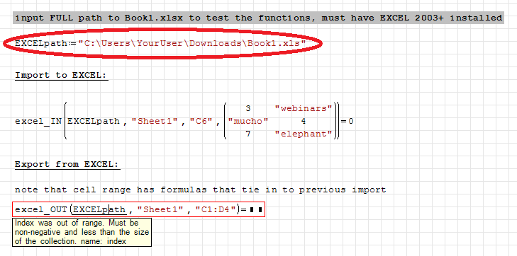

And... There is an error. Screenshot is attached.
#4 Posted: 4/16/2015 6:14:15 AM
Tried today with Excel 2010, i get an "index out of range" exception with excel_OUT and excel_IO (no issues with excel_PNG and excel_IN)

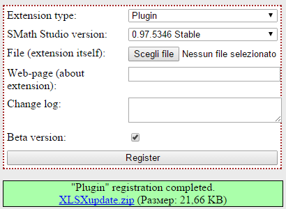

About the registration of the plugin, I've tried and I haven't noticed issues (used just the dll in an uncompresed archive)

Could you please confirm that "index out of range" error is due to file not being specified correctly? Circled is generic path that needs to be changed. I will update the plugin so correct exception is shown.
Error is shown with the correct path and file name "C:\Users\\Desktop\HowTo\HowTo\Book3.xls" and also with relative path "Book3.xls" or "folder\Book2.xls"

Could you help me to debug the error (given it is non reproducible on my end).
I have compiled a plugin .dll that will help to pin point what section of code throws the exception - could you please run it using Smath workbook, xls file and plugin attached and let me know the results?
Thanks!
Test ExcelOUT.zip (912.57 KiB) downloaded 676 time(s).
#8 Posted: 4/17/2015 5:01:04 AM
Thanks!
Done! the error message now is "check input 3 "
If you put the plug-in files in the SMatht plugins directory, you receive this message:
You have to use the plugin in the latest stable version (I use a portable version to test it)
ioan92, I have built the plugin with SMath dlls v.0.97.5346.24640. If you see benefit in building for earlier SMath I can do that as well.

Unfortunately this is the part of code that I do not fully grasp (I had troubles outputting Object Array back to SMath myself and I have adopted the code from your plugin)
I have further broken it down line-by-line with "Try". If you run the workbook again with attached plugin we should be able to pinpoint it to particular line of code.
Thank you for helping!!

Now the error is "check input 8 ..."
More: I've tried changing system settings, the issue seems in localization stuff because if I use '.' as decimal separator all it works fine.
This is offending code:

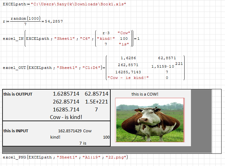

I have attempted properly substituting decimal separator using
Quote
result_temp1 = SMath.Manager.Converter.CorrectExpressionString(result_temp1, GlobalParams.DecimalSymbolStandard, GlobalParams.DecimalSymbol, GlobalParams.ArgumentsSeparatorStandard, GlobalParams.ArgumentsSeparator)
hopefully it works (worked for me with comma as a decimal separator, check screenshot).
Attached is recompiled plugin plus "short" version of smath workbook to test all 4 functions.

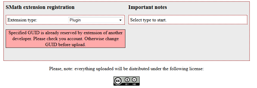

Davide, could you please remove your version of my plugin, i get following error:
#13 Posted: 4/17/2015 6:08:07 PM
Doesn't work, the issue is related to the system decimal separator (I suppose the number returned by excel uses the system settings)
Please try again using
result_temp1 = SMath.Manager.Converter.CorrectExpressionString(result_temp1, GlobalParams.DecimalSymbolSystem, GlobalParams.DecimalSymbol, GlobalParams.ArgumentsSeparatorSystem, GlobalParams.ArgumentsSeparator)
Plugin and folder was deleted immediatly after the upload, you have to ask Andrey to access manually the database
Andrey Ivashov 4/17/2015 8:52:00 PM
#14 Posted: 4/17/2015 8:51:55 PM
2,343 likes in 4,056 posts.

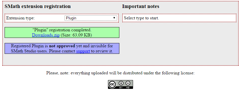

All references to uploaded by Davide extension removed. Please try to register extension again by yourself.
Plugin is updated as you suggested. Do you have ideas about a way to replicate the error on my side? I would really like this resolved.
Thank you for testing!
XLSXupdate.zip (18.91 KiB) downloaded 611 time(s).

#16 Posted: 4/18/2015 6:12:11 PM
Alexander O. Melnik
Alexander O. Melnik
127 likes in 498 posts.
I have successfully uploaded my plugin to extension manager.
Davide, Andrey - thank you for your help!
P.S.: Andrey, I believe you will need to review / approve it.
It works!
Tested mixing various SMath and system settings
To test it yourself go to the "control panel" > "region and language" and then change the system decimal separator (no needs to restart the system)
You can use also this shortcut from the search box of the start button
C:\Windows\System32\rundll32.exe shell32.dll,Control_RunDLL intl.cpl,,0
#18 Posted: 4/19/2015 2:10:37 AM
Approved OK with one comment: please don't include auto generated *.pdb and *.xml files into plug-in package next time.
Thank you!
