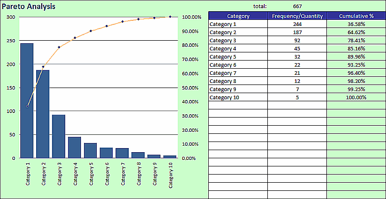

#62 Posted: 6/16/2016 10:23:25 AM
... what I understand in there: you have the Pareto software, you made the chart,
and transited to Excel to further paste back to Smath. Wouldn't it be simpler to
capture directly from Pareto, resize/resample, reduce 256 colors and paste in Smath ?
#63 Posted: 6/16/2016 10:32:40 AM
Alexander O. Melnik
Alexander O. Melnik
127 likes in 498 posts.
Jean, in my work I would like to avoid manual copy paste of data where possible to eliminate human error. Also it is often that I need to update 20 excel screenshots in a .SM workbook.. This plugin together with image region does it all by itself every time the workbook is evaluated.
Take for example charts. Excel formatting is miles beyond what Smath can do. Use excel_IN to feed the data, excel_PNG to dynamically display the chart.
What do you use for sharpening tool? Looks neat.
Thanks
P.S.: I know that my fascination with excel is arguable. I am all about using best tool for the task; however, often I am strongly encouraged to use spreadsheets, or as it is with graphs, excel just does a better job than Smath.

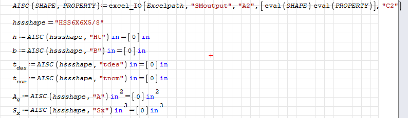

The excel_IO appears not to be working anymore as part of a custom function. It was working previously on my computer, but with one of the upgrades to SmathStudio it has stopped working. When the excel_IO is used as the right part of a custom function, the variables with equal signs get placed in the excel worksheet cells instead of the values of the variables. See the two screen shots below from the Steel Properties Look-up.sm and corresponding excel file. The excel_IO otherwise appears to work but not as right part of custom function with variable input.
#67 Posted: 10/7/2016 3:05:59 PM
Alexander O. Melnik
Alexander O. Melnik
I fixed the example: use line() function. I do not know why the behaviour differs with and without line; however, I did not spend much time investigating the behaviour once work around was found.
Steel Properties Look-up.sm (25.09 KiB) downloaded 2181 time(s).
AISC Shape Lookup.xlsx (3.27 MiB) downloaded 1924 time(s).
Also for excel screenshots I suggest using excel_EMF instead of excel_PNGv2 - produces great quality PDF prints. If you do, update both excel_IO and Image Region plugins to the latest version

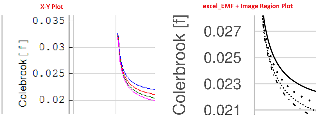

A sample of a Plot produced by combination of excel_EMF function and Image Region inside the SMath workbook.
The example was borrowed from one of the calculations by Jean Giraud.
Note the difference of as-printed quality between X-Y Plot output and excel_EMF output.
File not found.File not found.File not found.

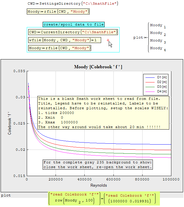

#71 Posted: 10/11/2016 12:09:50 PM
Thanks Alex,
My Excel 2003 opens your Excel sheet, but somethig(s) it does not like.
It must convert and the plots aren't managable, it's OK. I understand
your plug-in for those that don't work maths, also good for papers.
How did you get such a huge 7.75 MB image !
All the snippets I attach are captured from my 20 years old "WinGrab"
still freeware. After capture, select the portion then reduce colors
to 256 . Generally, WinGrab reduce 256 colors is better than my old
IrfanView. This snippet is 430 KB.
Smath is very convenient for working from files that are created from
the hard maths. As you can see: past the Moody creation, we just have
interest in retrieving any Colebrook 'f' [friction factor]. There is a
way to retrieve from specified Reynolds. It requires a module to search
through data table.
Cheers, Jean

#72 Posted: 10/11/2016 12:28:58 PM
Alexander O. Melnik
Alexander O. Melnik
Jean,
There are two ways to display EXCEL plots / ranges:
1. excel_PNG - produces LARGE bitmap files that print well at 300+ DPI
2. excel_EMF - produces a clipboard of a metafile (native .net vector graphics) which results in a vector graphics PDF prints.
I like using excel_EMF - it produces best as-printed quality plots and is much faster than excel_PNG
Also I saw that you were spooling "Moody" function output to file to speed up processing. No need for that - just define Moody:=eval(your_code) so the function is not executed every time you call it in a SMath worksheet.
