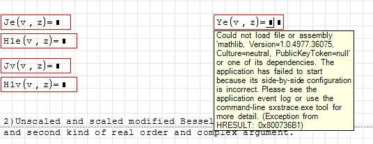

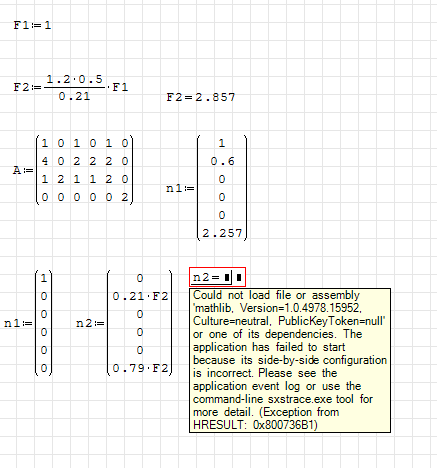

8/17/2013 8:39:14 PM [ERROR] [Plugin::Initialize()]: Could not load file or assembly 'mathlib, Version=1.0.4977.42823, Culture=neutral, PublicKeyToken=null' or one of its dependencies. The application has failed to start because its side-by-side configuration is incorrect. Please see the application event log or use the command-line sxstrace.exe tool for more detail. (Exception from HRESULT: 0x800736B1)
It's not as easy as I thought before. Please, try again.
Try to install Microsoft Visual C++ 2010 Redistributable Package (x86) or Microsoft Visual C++ 2010 Redistributable Package (x64).
QuoteThe Microsoft Visual C++ 2010 Redistributable Package installs runtime components of Visual C++ Libraries required to run applications developed with Visual C++ on a computer that does not have Visual C++ 2010 installed.
I tried it again, installed the VC++2010 Redistributable as well, but no success.
As I could see from the log.txt - there is only one additional line about successful initialize - but no functions loaded. I do not know what is the influence of the present "not working" condition but it seems that lots of files do not work anymore - see the pictures please

log contents:
18.08.2013 08:28:54 [ERROR] [Plugin.Initialize()] Die Datei oder Assembly "mathlib, Version=1.0.4978.15952, Culture=neutral, PublicKeyToken=null" oder eine Abhängigkeit davon wurde nicht gefunden. Diese Anwendung konnte nicht gestartet werden, da die Side-by-Side-Konfiguration ungültig ist. Weitere Informationen finden Sie im Anwendungsereignisprotokoll. Weitere Details können auch mit dem Befehlszeilentool sxstrace.exe angezeigt werden. (Ausnahme von HRESULT: 0x800736B1)
18.08.2013 08:28:54 [INFO ] [Plugin.Initialize()] Successfully. 0 functions loaded.
18.08.2013 08:46:01 [ERROR] [Plugin.Initialize()] Die Datei oder Assembly "mathlib, Version=1.0.4978.15952, Culture=neutral, PublicKeyToken=null" oder eine Abhängigkeit davon wurde nicht gefunden. Diese Anwendung konnte nicht gestartet werden, da die Side-by-Side-Konfiguration ungültig ist. Weitere Informationen finden Sie im Anwendungsereignisprotokoll. Weitere Details können auch mit dem Befehlszeilentool sxstrace.exe angezeigt werden. (Ausnahme von HRESULT: 0x800736B1)

WroteTry to install Microsoft Visual C++ 2010 Redistributable Package (x86) or Microsoft Visual C++ 2010 Redistributable Package (x64).
According to system control I have Visual C++ Redistributable 2005 installed. The 2010 installer fails and complains that a newer version is installed. Actually I don't know the dependencies and therefore I am hesitating to intervene.
I have both programs: VS2008 and VS2010, so everything works. Cephes consists of very old sources, written in C (I tried to fix the code so that it looks like C++). Compile them is difficult. VS tries to connect the old library, which is not on your machine.
As for the other plugins, I think it is in violation of the logic of the chain. Symbolic part of this plugin is also included in the work, but because the functions are not loaded it returns an error (false) somewhere in the call chain. I'm not sure about this, here it is necessary to consult with Andrey.
The ODESolvers project configured in the same way and it works. Therefore, I think the problem is in the old C code that I was not able to put in a modern look. I would like to compile the source code for the 64-bit platform too.
WroteI don't know why, but the plugin uses libraries from VS2008: msvcm90.dll (release version) and msvcm90d.dll (debug version). The project is compiled in debug configuration, as in the release it doesn't launch. So, I think you need to try to install Microsoft Visual C++ 2008 Redistributable Package (x86) or Microsoft Visual C++ 2008 Redistributable Package (x64) instead of VC++ 2010.
Sorry, install of VC++ 2008 (went without problems) did not help.

WroteUpdated. Well, the last time. I compiled plugin in the release configuration. Maybe this version will work. And show me the log file.
Much better now, yet still problems. Part of the functions now work and no side effenct so far.
