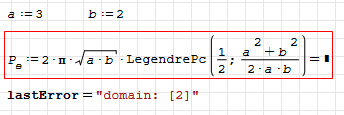

#30 Posted: 7/9/2021 11:42:23 PM
600 likes in 1,381 posts.
Plugin doesn't seem to evaluate functions.
Gives "domain: [#]" error, don't know the meaning.
#31 Posted: 7/10/2021 1:26:36 AM
1,558 likes in 1,868 posts.
SMath Studio compatibility
Plugin updated.
Changes:
- refactored.
This error means that the second argument was out of bounds. The function checks the value of the arguments before calling.
