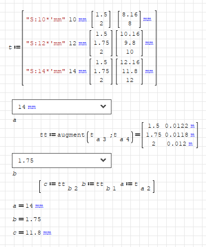

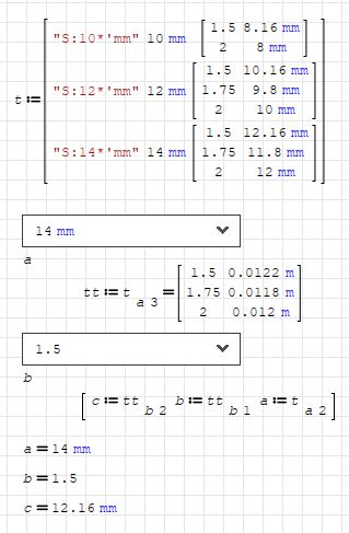

You may need a temp data derived from first combobox selection.
And use that new data at second combobox.
Here is your both questions answered.
combobox_question.sm (8.36 KiB) downloaded 1273 time(s).

You can reduce data matrix like this too.
combobox_question.sm (8.29 KiB) downloaded 1318 time(s).
