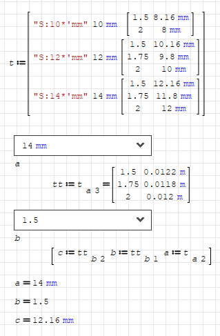

#2 Опубликовано: 17.07.2022 16:42:53
Question 1: How can I do that?
Question 2: Choosing from a list of values "a" with this assignment of the matrix values are repeated. How to avoid it?
You may need a temp data derived from first combobox selection.
And use that new data at second combobox.
Here is your both questions answered.
combobox_question.sm (8,36 КиБ) скачан 1273 раз(а).

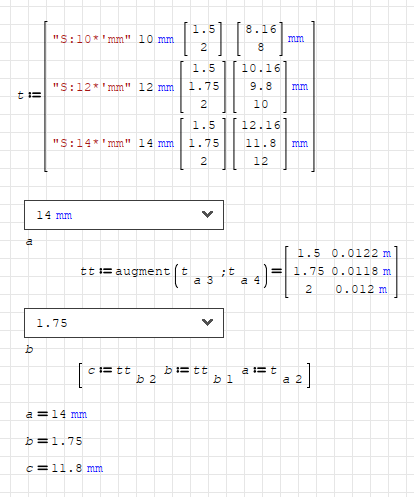

#3 Опубликовано: 17.07.2022 17:28:21
You can reduce data matrix like this too.
combobox_question.sm (8,29 КиБ) скачан 1318 раз(а).
#4 Опубликовано: 18.07.2022 14:42:50
Prmtv
Prmtv
0 сообщений из 49 понравились пользователям.
Exactly what is needed. Thank you!
