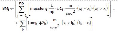

I am trying to convert a Mathcad 15 sheet, and have a problem with the below equation:
Is there a summation within Smath that will do the second summation?

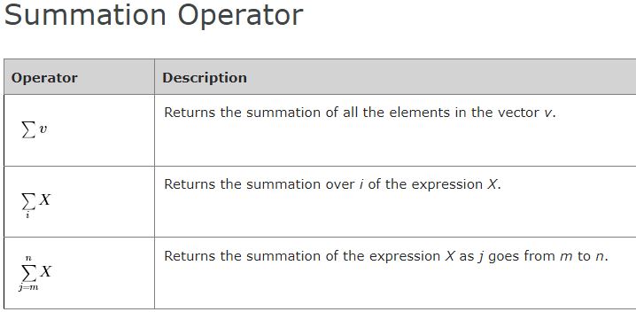

From the Mathcad help:

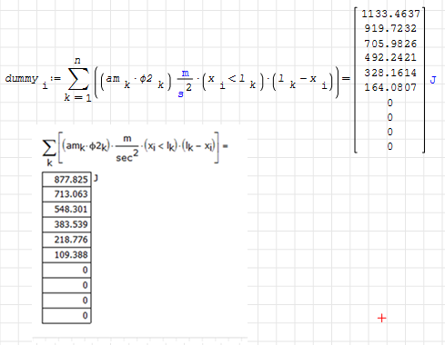

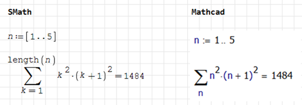

#2 Posted: 12/9/2021 12:33:55 PM
1,139 likes in 1,805 posts.
Hi. There are not equivalent, but this is how to convert it into usual summation operator.

#5 Posted: 12/10/2021 8:18:09 AM
Attached is sheet, this is a MRM for beam frequency analysis
Sum over 'n' ... NOT over 'k'
Model summation attached.
Function Running Summation.sm (32.66 KiB) downloaded 1352 time(s).

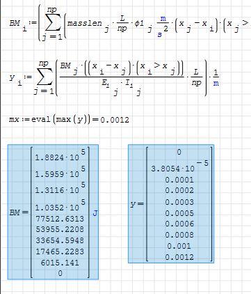

#12 Posted: 12/10/2021 3:00:17 PM
1,558 likes in 1,868 posts.
I think that there should be such a replacement.
#13 Posted: 12/10/2021 3:09:11 PM
You can use debugging in both programs to check that the functions are working correctly.
Click to enlarge
