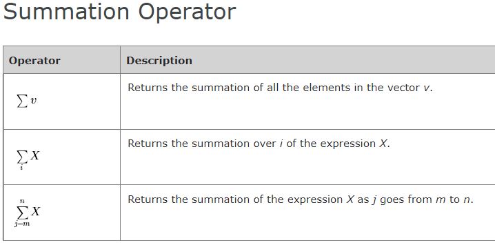

I am trying to convert a Mathcad 15 sheet, and have a problem with the below equation:
Is there a summation within Smath that will do the second summation?
From the Mathcad help:
Thanks in advance
Ian

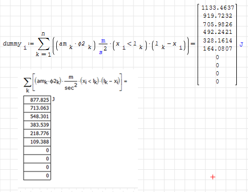

#2 Опубликовано: 09.12.2021 12:33:55
Hi. There are not equivalent, but this is how to convert it into usual summation operator.

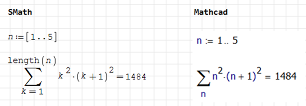

#5 Опубликовано: 10.12.2021 08:18:09
Attached is sheet, this is a MRM for beam frequency analysis
Sum over 'n' ... NOT over 'k'
Model summation attached.
Function Running Summation.sm (32,66 КиБ) скачан 1352 раз(а).

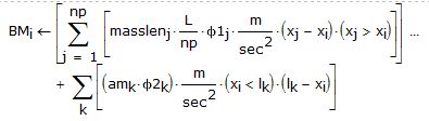

#12 Опубликовано: 10.12.2021 15:00:17
I think that there should be such a replacement.

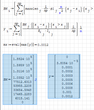

#13 Опубликовано: 10.12.2021 15:09:11
You can use debugging in both programs to check that the functions are working correctly.
