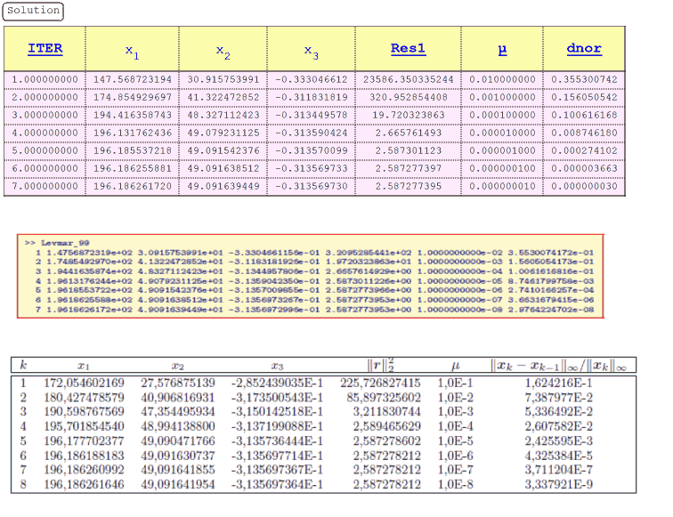

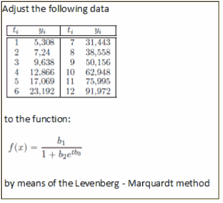

#1 Posted: 7/17/2018 9:17:58 PM
CBG
CBG
78 likes in 312 posts.
Levenberg_Marquardt_Code_CBG.sm (137.38 KiB) downloaded 1371 time(s).
