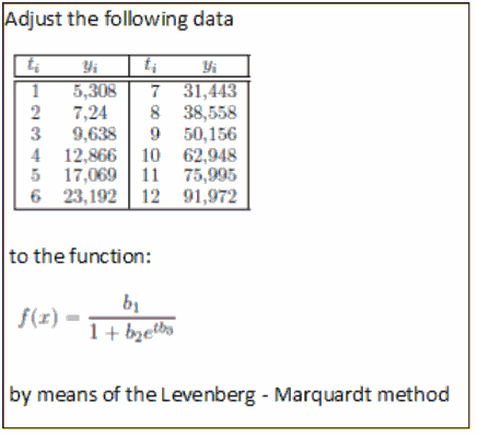

Levenberg Marquardt Method
Levenberg Marquardt Method - A simple sample of the application of the Levenberg Marquardt method - Сообщения
#1 Опубликовано: 17.07.2018 21:17:58

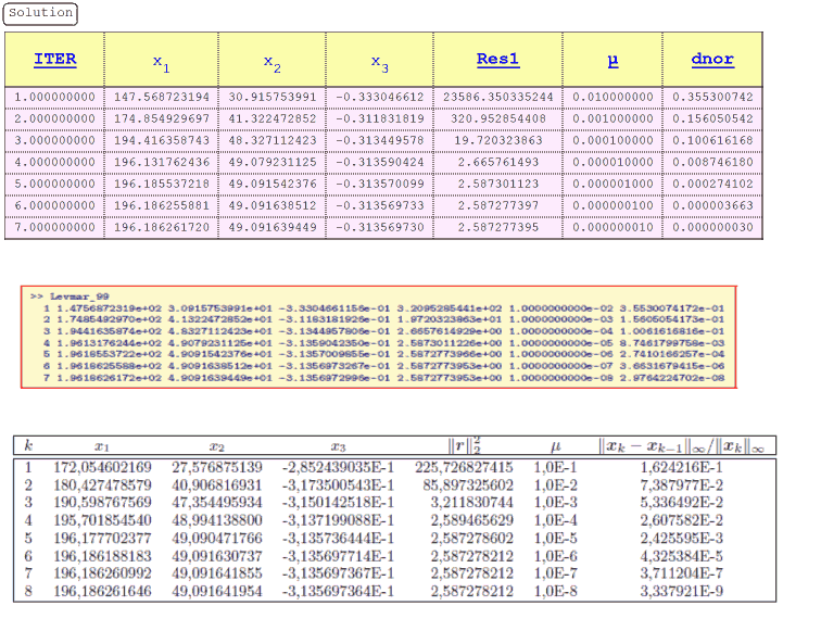

#2 Опубликовано: 18.07.2018 00:03:02
Thanks Carlos,
For meditation. Hover the pointer on φ(x,β) to see Conjugate Gradient.
The model is puzzling, if you want so: can try expGrow as an exercise.
Genfit Minimize MODEL Test.sm (39,95 КиБ) скачан 1298 раз(а).
