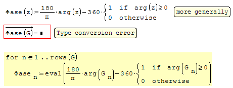

... more general definition of phase:
Project Admittance Copy.sm (155.54 KiB) downloaded 1360 time(s).

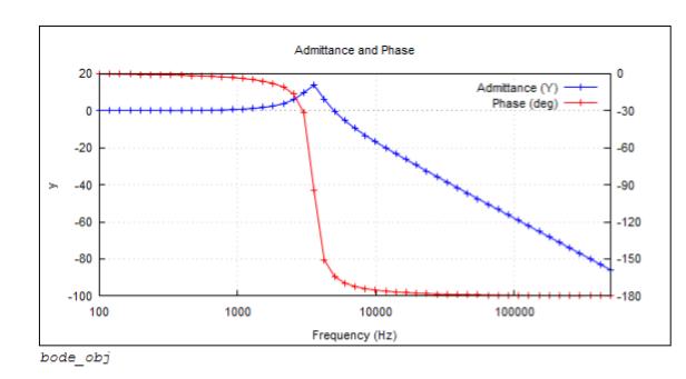

Figured out how to use Maxima's Draw2D(). This also looks nice for a logx plot. Plotted both Admittance and Phase in same graph. I like this as well because properties can be changed directly in SMath sheet.
I played around with XY Plot but was unable to find a way to use log axes.
Project Admittance Copy_Maxima_Draw2D_alyles.sm (183.41 KiB) downloaded 1475 time(s).

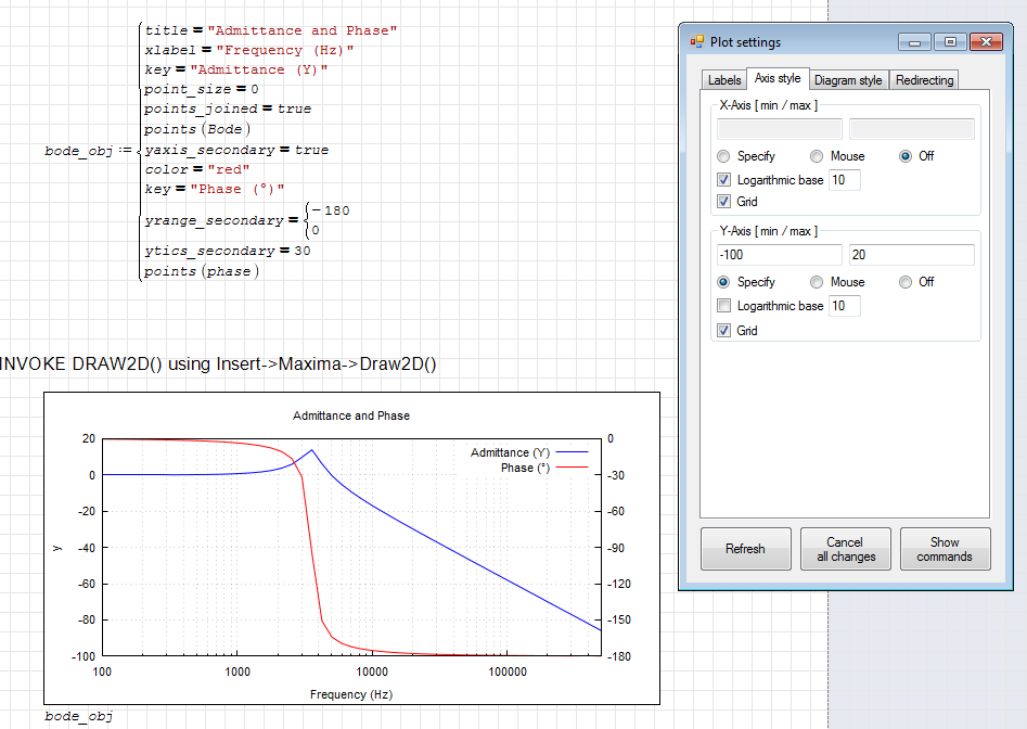

#7 Posted: 5/22/2018 1:55:59 PM
Nice example!
I did a bit of cleanup, removed the markers and shifted some options to the settings dialog.
![2018-05-22 18_50_32-SMath Studio - [Project%20Admittance%20Copy_Maxima_Draw2D_alyles_Kr.sm_].png](/en-US/files/Download/wLcyFy/2018-05-22-18_50_32-SMath-Studio---[Project%20Admittance%20Copy_Maxima_Draw2D_alyles_Kr.sm_].png)
Project%20Admittance%20Copy_Maxima_Draw2D_alyles_Kr.sm (97.31 KiB) downloaded 1606 time(s).
