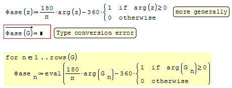

#5 Опубликовано: 22.05.2018 10:58:42
... more general definition of phase:
Project Admittance Copy.sm (155,54 КиБ) скачан 1360 раз(а).
