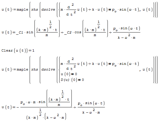

#2 Posted: 6/30/2024 9:32:27 PM
1,558 likes in 1,868 posts.
Symbolic results from ODE.sm (9.74 KiB) downloaded 1590 time(s).
3 users liked this post
netsonicyxf 7/1/2024 8:47:00 AM, sergio 7/15/2024 3:04:00 PM, Valery Ochkov 6/30/2024 11:33:00 PM
Thank you. How do you input ",u(t)" in the brace?
#6 Posted: 7/1/2024 1:06:09 PM
Valery Ochkov
Valery Ochkov
67 likes in 713 posts.
I think so
dsolve( , u(t))
netsonicyxf 7/1/2024 9:44:00 PM

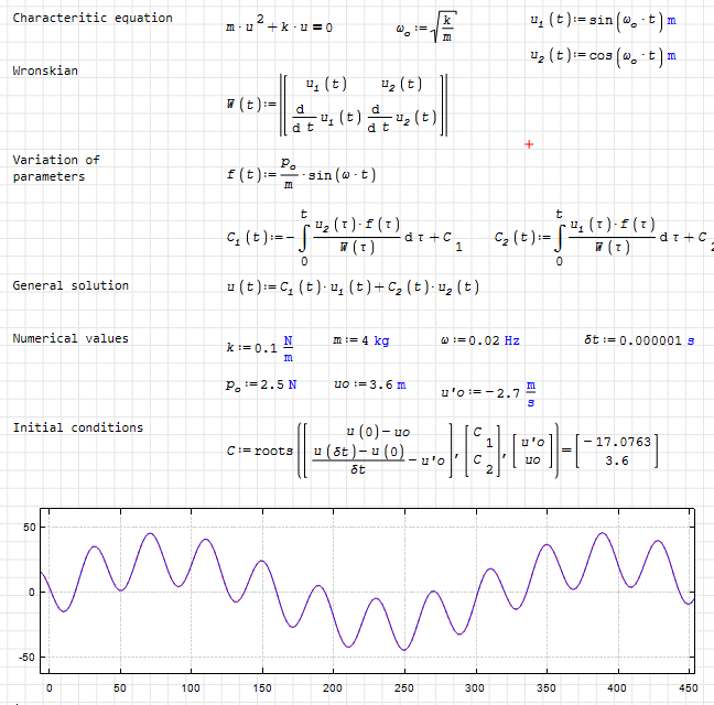

#7 Posted: 7/2/2024 10:34:21 PM
1,139 likes in 1,805 posts.
Plugin less solution, with units, using the Wronskian and the variation of parameters method.
Symbolic results from ODE.sm (23.52 KiB) downloaded 1558 time(s).
Davide Carpi 7/3/2024 11:46:00 PM, netsonicyxf 7/6/2024 9:09:00 PM, sergio 7/15/2024 3:16:00 PM
