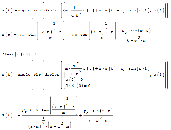

How to get symbolic results from ODE?
#2 Опубликовано: 30.06.2024 21:32:27
Symbolic results from ODE.sm (9,74 КиБ) скачан 1590 раз(а).
netsonicyxf 01.07.2024 08:47:00, sergio 15.07.2024 15:04:00, Valery Ochkov 30.06.2024 23:33:00

Thank you. How do you input ",u(t)" in the brace?
I think so
dsolve( , u(t))

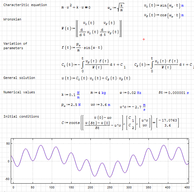

Plugin less solution, with units, using the Wronskian and the variation of parameters method.
Symbolic results from ODE.sm (23,52 КиБ) скачан 1558 раз(а).
Davide Carpi 03.07.2024 23:46:00, netsonicyxf 06.07.2024 21:09:00, sergio 15.07.2024 15:16:00
