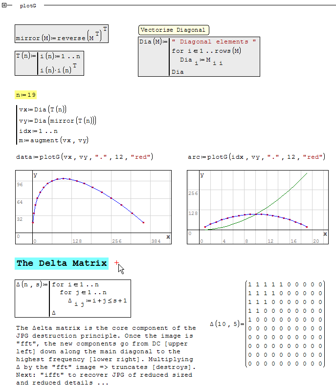

#24 Posted: 9/10/2016 11:51:19 AM
WroteI hoped this might be the most simplest way.
Not so easy ! At the machine code, everything is linear.
That's what the "ct" counter does system wise, then returned
math style. Just a bit more about Delta matrix. The JPG
explanation is short, just the principle of it. There is lot
more behind the scene.
Utilities Matrix Mirror QUICK.sm (17.59 KiB) downloaded 1631 time(s).
Radovan Omorjan 9/10/2016 1:28:00 PM
