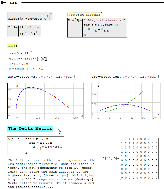

#24 Опубликовано: 10.09.2016 11:51:19
I hoped this might be the most simplest way.
Not so easy ! At the machine code, everything is linear.
That's what the "ct" counter does system wise, then returned
math style. Just a bit more about Delta matrix. The JPG
explanation is short, just the principle of it. There is lot
more behind the scene.
Utilities Matrix Mirror QUICK.sm (17,59 КиБ) скачан 1543 раз(а).
Radovan Omorjan 10.09.2016 13:28:00
