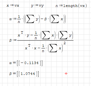

#1 Posted: 12/7/2017 10:26:50 AM
Can't explain to myself double/triple nesting [6179 Win 7].
Bugs SlopeIntercept.sm (10.34 KiB) downloaded 1365 time(s).

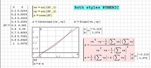

#2 Posted: 12/7/2017 12:13:11 PM

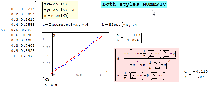

Hello Jean,
something to check in the symbolic engine; change the optimization of a:Intercept(vx,vy) from symbolic to numeric
frapuano 12/7/2017 2:40:00 PM
#3 Posted: 12/7/2017 2:03:58 PM
Thanks Davide ... works fine Numeric !

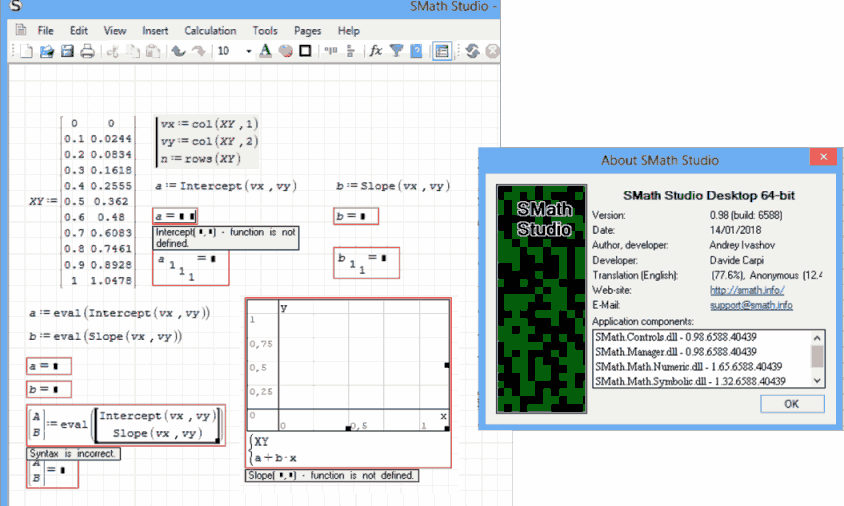

I get these errors when I run the file:
#7 Posted: 1/16/2018 12:23:07 AM
Carlos, try this one [done Smath 6179]
Maths SlopeIntercept.sm (9.07 KiB) downloaded 1298 time(s).
#8 Posted: 1/16/2018 2:02:49 AM
CBG
CBG
78 likes in 312 posts.
Thanks Jean, but I get the same error.
Is your Smath studio 32-bit?
My Smath Studio 64-bit, does not recognize the
functions of Interception and slope.

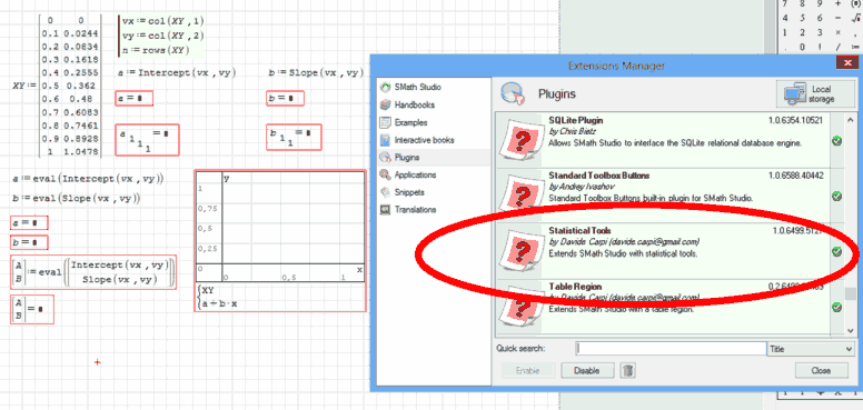

Hello!
Jean's example also works in my laptop (Win 10, 64 bit) with latest SS 6588 dated 14/01/2018.
The Functions are in Statistical Tools Plugin.
#10 Posted: 1/16/2018 5:36:02 AM
Carlos, do you have statistical tools plug-in installed and enabled?
Yes I have it.
