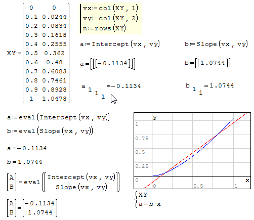

Can't explain to myself double/triple nesting [6179 Win 7].
Bugs SlopeIntercept.sm (10.34 KiB) downloaded 1334 time(s).

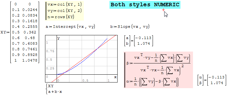

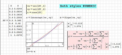

#3 Posted: 12/7/2017 2:03:58 PM
Thanks Davide ... works fine Numeric !
#4 Posted: 1/15/2018 12:59:36 AM
Fixed. Will be available with a next nightly build.
Thank you!

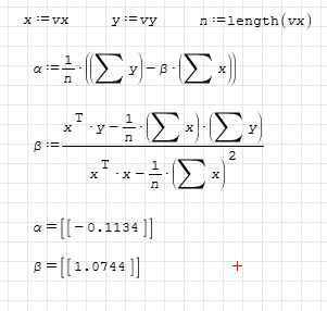

WroteI get these errors when I run the file:
Carlos, try this one [done Smath 6179]
Maths SlopeIntercept.sm (9.07 KiB) downloaded 1258 time(s).

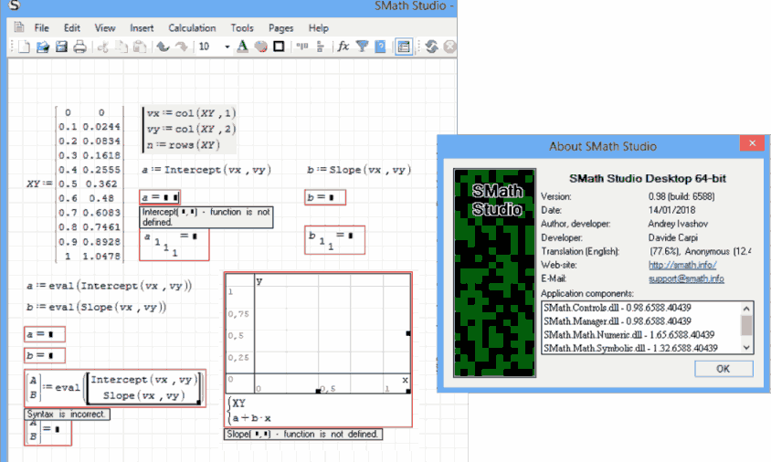

#8 Posted: 1/16/2018 2:02:49 AM
Thanks Jean, but I get the same error.
Is your Smath studio 32-bit?
My Smath Studio 64-bit, does not recognize the
functions of Interception and slope.

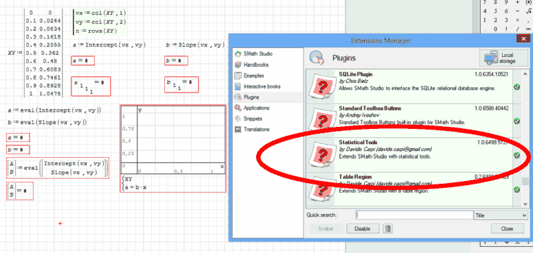

WroteMy Smath Studio 64-bit, does not recognize the
WroteThe Functions are in Statistical Tools Plugin.
Carlos, do you have statistical tools plug-in installed and enabled?
#11 Posted: 1/16/2018 7:04:34 PM
#12 Posted: 1/17/2018 4:57:25 AM
I see, trying to figure out what's happening here
