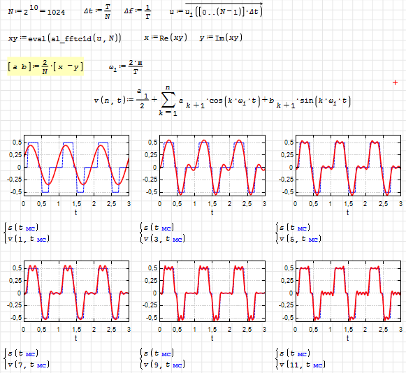

With numeric optimization (for all functions) it works much faster.
Fourier series coefficients.sm (17.54 KiB) downloaded 1791 time(s).
Fourier series coefficients.pdf (138.41 KiB) downloaded 1068 time(s).

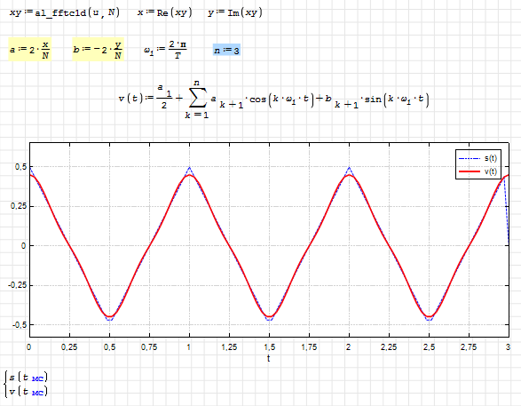

Example 2.
Fourier series coefficients.sm (28.46 KiB) downloaded 1925 time(s).
Fourier series coefficients.pdf (170.26 KiB) downloaded 1216 time(s).

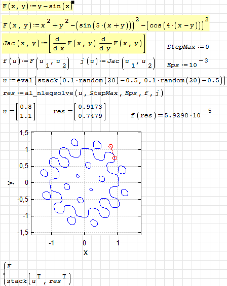

1. SS 6179 does not complain
2. Takes ~ 1 hr to terminate the first function
3. NO plot result [NO complain but NO plot ?]
4. Would be interesting checking if the attached SS 6179
runs in your actual AlgLib 3.1x. If NOT => would be a dramatic bug.
It would indicate that all maths based al_nleqsolve would be scrap.
Contour SOLVE [Electron Solve algo Express].sm (20.66 KiB) downloaded 1569 time(s).
