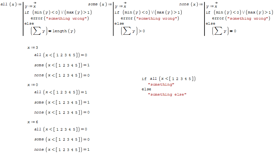

#5 Posted: 5/9/2022 8:37:41 AM
You can always create some function to make it look like you are working with some set of numbers

#6 Posted: 5/9/2022 10:06:38 AM
Tanks Davide ... coded/saved.

#7 Posted: 5/9/2022 11:25:27 AM
1,139 likes in 1,805 posts.
Hi Davide. Great idea. These functions can be very useful for translating matlab programs. They can also be extended to arrays, as the all, any and nnz functions do.
