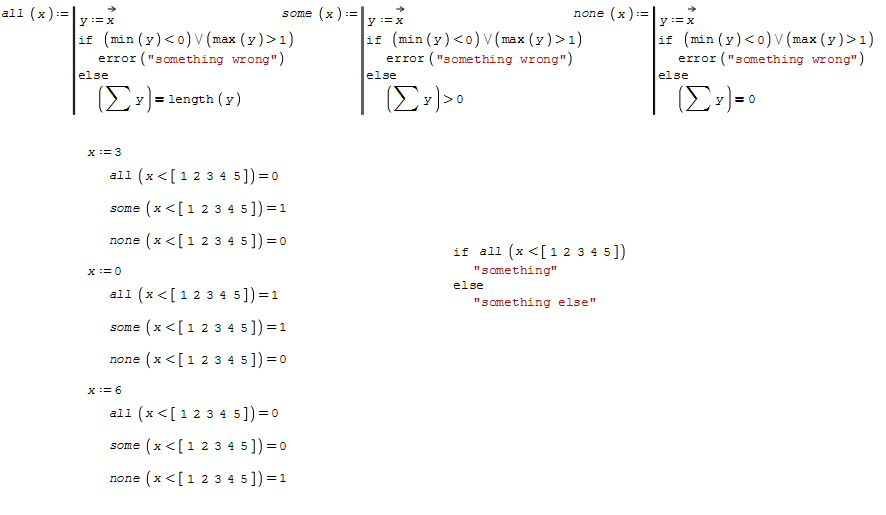

You can always create some function to make it look like you are working with some set of numbers

#6 Опубликовано: 09.05.2022 10:06:38
Tanks Davide ... coded/saved.

#7 Опубликовано: 09.05.2022 11:25:27
Hi Davide. Great idea. These functions can be very useful for translating matlab programs. They can also be extended to arrays, as the all, any and nnz functions do.
